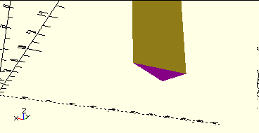

Generally CGAL errors seem to be related to winding errors (listing
points on a face in the wrong order), manifold errors (two shapes that
touch along one line), and the ilk.
In this case, extracting that one line and looking at it with
View/Thrown Together and F5, the bottom face is purple.  That means it's
wound backwards, that it's inside-out.  That's the [0,1,2] face.
Reversing it to [2,1,0] turns that face yellow.
See if that helps.

Yep, that fixed it. Thanks a lot. I had assumed that was an error on the
wrong line so I wasn't seeing my issue. I gotta remember that. I always get
one face backwards.
