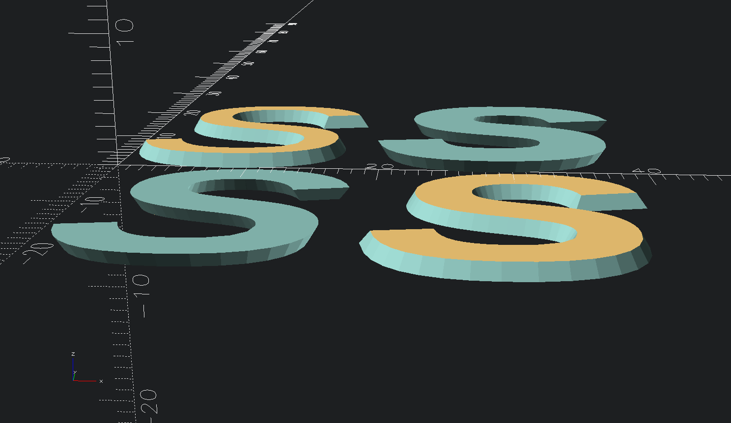

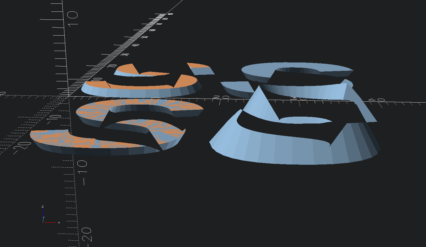

why does this script preview so differently from the render?
TA
Todd Allen
Fri, Sep 18, 2026 8:43 PM
universe = 100;
module conditional_zflip_z(condition, z=0) {
if (condition)
scale([1,1,-1]) translate([0,0,-z]) children();
else children();
module conditional_offset(condition, delta) {
if (condition)
offset(delta=delta) children();
else children();
// generates an extrusion from z=0 and cropped at z=rise.
// extrusion tapers inward with positive run and outward with negative run
module roofrr(rise=1, run=1, s=universe) {
assert(run != 0, "run can not be zero.")
assert(rise != 0, "rise can not be zero.")
assert(s != 0, "s can not be zero.")
conditional_zflip_z(run<0, z=rise)
scale([1,1,rise/abs(run)]) roof() conditional_offset(run<0,
delta=-run) children();
translate([0,0,rise>0 ? rise+s0.5 : rise-s0.5]) cube([s,s,s],
center=true);
module mytext() scale([2,2]) text("S", font="Liberation Sans:style=Bold
Italic");
module position(x,y) translate([20x,20y,0]) children();
position(0,0) roofrr(rise=1.0, run=0.6) mytext();
position(0,-1) roofrr(rise=-1.0, run=0.6) mytext();
position(1,0) roofrr(rise=1.0, run=-0.6) mytext();
position(1,-1) roofrr(rise=-1.0, run=-0.6) mytext();
The render:
[image: 037b7cb7-67de-492b-aef1-d313fb28fc73.png]
The preview:
[image: roofrr preview.png]
Looking at the preview from a variety of angles gives an impression of
something like the cube being subtracted is z fighting with its target.
Can someone explain how the preview is generated and why this happens?

The convexity argument is too low somewhere.  Looks like giving
roof(convexity=10) fixes it.

Thanks!  It's been a long time since I have had a convexity issue and did
not think of it as something that might affect preview but not render.  I
guess that is because preview does raytracing?

Fine!  10 would be a huge improvement over 1!  I withdraw my shoot-from-the-hip request for 100. :) On 9/18/2026 7:26 PM, Adrian Mariano via Discuss wrote: > Yes, convexity=10 is fine on my system, but convexity=100 leads to > jerky, slow scrolling with large models. I'm using on board > graphics---no graphics card---so my graphics is weak. > > On Fri, Sep 18, 2026 at 7:20 PM Father Horton via Discuss > <discuss@lists.openscad.org> wrote: > > Is there processing overhead with a higher default? > > On Fri, Sep 18, 2026 at 6:18 PM Jon Bondy via Discuss > <discuss@lists.openscad.org> wrote: > > I've never understood why the default for Convexity is 1.  > Make it 100, and many of these bug reports would vanish. > > Jon > > On 9/18/2026 7:05 PM, Todd Allen via Discuss wrote: >> Thinking about it a bit more I've likely had plenty of >> convexity issues that were less extreme and easily ignored.  >> I'll probably find more now. >> >> On Fri, Sep 18, 2026, 5:51 PM Todd Allen >> <speedebikes@gmail.com> wrote: >> >> Thanks!  It's been a long time since I have had a >> convexity issue and did not think of it as something that >> might affect preview but not render.  I guess that is >> because preview does raytracing? >> >> > > <https://urldefense.proofpoint.com/v2/url?u=http-3A__www.avg.com_email-2Dsignature-3Futm-5Fmedium-3Demail-26utm-5Fsource-3Dlink-26utm-5Fcampaign-3Dsig-2Demail-26utm-5Fcontent-3Demailclient&d=DwMFaQ&c=euGZstcaTDllvimEN8b7jXrwqOf-v5A_CdpgnVfiiMM&r=AsrE-c7ZR7B2Kyr3qgfvvppkCEBVsNmwEMndcrRSuOI&m=WeWxkJ55Ah0_uFV1RmfelMhehM99FY7K09xyGJkHBMwJSxL1eIdEW8zECWks5QtT&s=XZI6FGhfuWrRlVtZ_eMwyFY15TjBffz_o6UyWyCKqvc&e=> > Virus-free.www.avg.com > <https://urldefense.proofpoint.com/v2/url?u=http-3A__www.avg.com_email-2Dsignature-3Futm-5Fmedium-3Demail-26utm-5Fsource-3Dlink-26utm-5Fcampaign-3Dsig-2Demail-26utm-5Fcontent-3Demailclient&d=DwMFaQ&c=euGZstcaTDllvimEN8b7jXrwqOf-v5A_CdpgnVfiiMM&r=AsrE-c7ZR7B2Kyr3qgfvvppkCEBVsNmwEMndcrRSuOI&m=WeWxkJ55Ah0_uFV1RmfelMhehM99FY7K09xyGJkHBMwJSxL1eIdEW8zECWks5QtT&s=XZI6FGhfuWrRlVtZ_eMwyFY15TjBffz_o6UyWyCKqvc&e=> > > > <#m_3165102810642234509_m_-3346072149058589412_DAB4FAD8-2DD7-40BB-A1B8-4E2AA1F9FDF2> > _______________________________________________ > OpenSCAD mailing list > To unsubscribe send an email to discuss-leave@lists.openscad.org > > _______________________________________________ > OpenSCAD mailing list > To unsubscribe send an email to discuss-leave@lists.openscad.org > > > _______________________________________________ > OpenSCAD mailing list > To unsubscribe send an email todiscuss-leave@lists.openscad.org -- This email has been checked for viruses by AVG antivirus software. www.avg.com
Michael Marx (spin)
Sat, Sep 19, 2026 12:16 AM
Convexity has a performance hit, higher & it needs to do more work, basically a direct multiplication,
but preview is quick, so n*quick can usually be OK for low values of n.
Increasing the default has been raised a number of times, but no ideal number comes up.
It's been a long time since I have had a convexity issue and did not think of it as something that might affect preview but not render.  I guess that is because preview does raytracing?
Technically not Raytracing, something like it.
It builds a depth buffer(Z buffer) stack of all the faces of things, then determines which bits are visible from the camera,
"First, only the front face of intersected and the back
face of subtracted primitives are potentially visible.
Second, each other primitive P affects the visibility of a
pixel in a potentially visible polygon by the number of
polygons of P in front of the pixel (called the parity,
which, for convex primitives, is always in-between zero
and two): If P is subtracted and the parity is one, the
pixel is not visible, and if P is intersected and the parity
is zero or two, the pixel is also not visible."
OpenCSG: A https://www.opencsg.org/data/csg_freenix2005_paper.pdf  Library for Image-Based CSG Rendering (2005)
It's more complicated, read the linked paper, Figure 2. helps.
Also this one https://dl.acm.org/doi/pdf/10.1145/285305.285308  1998 (unfortunately a better quality version is not freely available).
