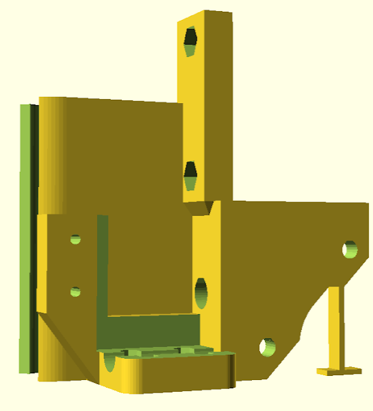

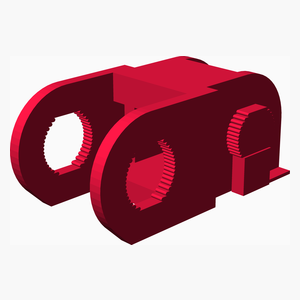

Mon, May 10, 2021 10:05 PM
Yes I do the same. I suppress the support in assembly views but enable it
when making the STL
I add the support manually because a library that did it
automatically would tend to put it in the same places a slicer would.
