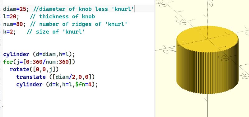

Sat, Dec 14, 2024 12:13 PM
Knurling is used in machining, as a simple method often in a lathe work
to add a grippy surface  (usually by embossing a fine pattern) to a
metal cylinder. If you are 3d printing, you can get much better methods
of getting a grip, allowing the fdm process to remove the sharp edges
that can occur in the knurling of metal components, so sharp points are OK.
So, start with the cylinder with the recess for the nut, then simply
rotate shapes to give a suitable number of ridges - very similar to the
star problem that Mike had. As you found out, Minkowski can be very
slow, and does not always work - it often 'produces too many small
triangles'
Personally, i would not use fine knurling, simply adjust num and remove
the $fn=4, and make k bigger, so that there are fewer,  but larger
rounded ridges.

So, start with the cylinder with the recess for the nut, then simply rotate shapes to give a suitable number of ridges - very similar to the star problem that Mike had. As you found out, Minkowski can be very slow, and does not always work - it often 'produces too many small triangles'
<knurl.jpg>Personally, i would not use fine knurling, simply adjust num and remove the $fn=4, and make k bigger, so that there are fewer,  but larger rounded ridges.
My first solution was very basic with recesses like you recommend. But then I was somewhat pulled into this starting to make a multi-purpose library. The example I posted here was just a very simplified, focused on the problem, variant of the actual implementation. I came up with cylinders of different radii touching each other to make a smooth perimeter along the circumference. Many things can be configured and I went through several refactorings until I ran into the problem posted here. With the manifold backend recommended by Chun Kit Lam and Ken everything works like a charm and considerably faster as well.
On 13/12/2024 21:56, Thomas Richter via Discuss wrote:
Sorry for possible double postings. I already sent this a couple of hours ago but it never showed up in the mailing list. Is there some acknowledgement process performed by the list admins? I didn't find any resources about the do's and don'ts on this list.
My question:
I am creating simple knobs for hexagonal head screws (see simplified code below). The preview works but when rendering I get this error:
ERROR: The given mesh is not closed! Unable to convert to CGAL_Nef_Polyhedron.
Until now I only saw this when importing broken stl files but never with calculated geometries. The error vanishes if I remove the last element of the difference, marked with the comment "cut off excessive height from minkowski operator".
Even more strange: Yesterday it used to work with an edgeRadius of 2.02 instead of 2 but after a few slight changes it doesn't do anymore. With radius 2 it never worked.
I would appreciate if someone could test this and let me know if this appears to just be a platform related problem caused by cumulating floating point errors. I am using a Macbook with M3 cpu.

On 14/12/2024 14:16, Adrian Mariano via Discuss wrote:
I don't know about the idea that you can just make it sharp.
I was referring to knurling, not daggers... Often folk do not get
knurling correct in metal work, leaving sharp peaks on the surface of
the ridges. The nature of 3d fdm printing is that you are unlikely to
get a point sharper than the radius of the nozzle, using a normal
slicer. You can see that in the image below (a much enlarged section
from the 20mm diameter piece from before, you can possibly see the light
grey of the original stl points at the base)..
If the sharp points on the hedgehogs are a nuisance, then print in a
flexible (tpu) filament, or quickly go over it with a heat gun/blow
torch/whatever, or print in abs and 'polish' using acetone - other safer
solvents are available for this and some other plastics.
