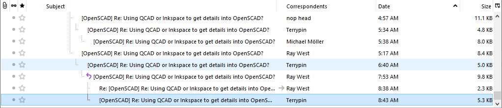

Many or most e-mail clients use mostly-hidden message headers to track
reply chains, so that they can display messages in "threads".
Ray, I see that you're using Thunderbird.  Try View / Sort By /
Threaded.  You should get a display sort of like:
On 6/3/2021 8:43 AM, Terrypin wrote: > BTW, here in the forum the posts always include a link like this at > their top left: Many or most e-mail clients use mostly-hidden message headers to track reply chains, so that they can display messages in "threads". Ray, I see that you're using Thunderbird.  Try View / Sort By / Threaded.  You should get a display sort of like:
