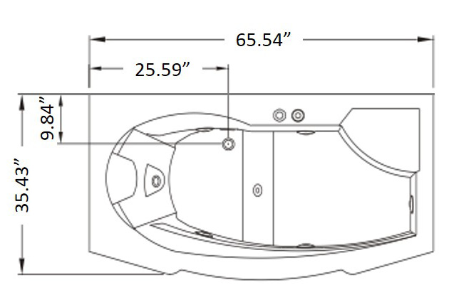

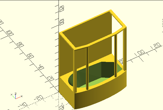

I was modelling a steam shower-bath unit; the curvy part was the bathtub
part and so I wanted to model both the curve around the top of the
bathtub and the curve around the bottom.  I probably could have created
DXF drawings for the two curves, and hulled them to create an object to
subtract away, but that seemed harder.
I still had a hull-related issue; the tub was slightly concave at one
point and the hull that I used to connect the two curves chopped that
off.  I didn't feel like spending the effort to get it exactly right.

Here's pictures.  (I knew you would be thrilled :-)  This is for a
possible bathroom remodel, not what's actually in the house, and so I
didn't go to my usual level of detail.
Mesa 807A Steam Shower Tub Combo 67"L x 35"W x 86"H
