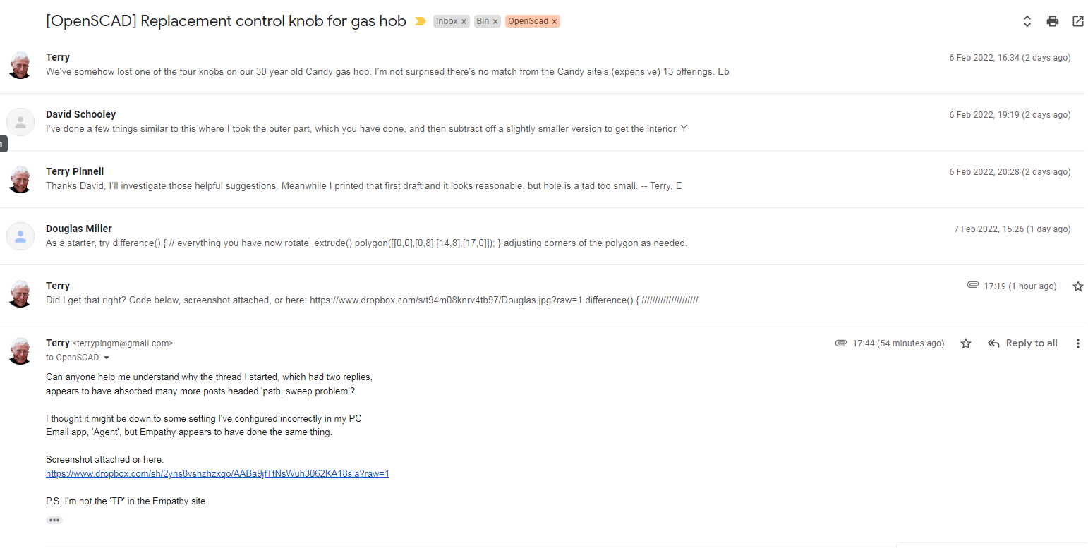

Can anyone help me understand why the thread I started, which had two replies,
appears to have absorbed many more posts headed 'path_sweep problem'?
I thought it might be down to some setting I've configured incorrectly in my PC
Email app, 'Agent', but Empathy appears to have done the same thing.
Screenshot attached or here:
https://www.dropbox.com/sh/2yris8vshzhzxqo/AABa9jfTtNsWuh3062KA18sla?raw=1
P.S. I'm not the 'TP' in the Empathy site.
which had two replies, appears to have absorbed many more
That is because the mail headers say so:
Message-Id: CCD315DA-55DD-4AE6-A506-1C97AFB35EDE@gmail.com
Subject: [OpenSCAD] Re: Replacement control knob for gas hob
and
In-Reply-To: CCD315DA-55DD-4AE6-A506-1C97AFB35EDE@gmail.com
Subject: [OpenSCAD] path_sweep problem
The "In-Reply-To" directly references the previous mail, so
the correct way to display that is what your mail program
shows.
Looks like Google decided to ignore that when the title of
the mail changes.

Thanks Torsten, understood.
