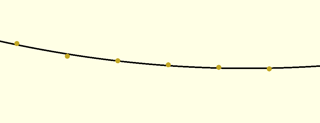

Sun, Jan 23, 2022 3:59 PM
Since this is the OpenSCAD list, how about a solution using OpenSCAD!
Below is a quadratic least squares fit using BOSL2.  Of course,
whether this is the right thing to do depends on those questions Ari
asked.
include<BOSL2/std.scad>
$fn=16;
data = [[5,2.6],[6,2.35],[7,2.26],[8,2.18],[9,2.13],[10,2.1]];
// Solve least squares problem:
x = column(data,0);
y = column(data,1);
const = repeat(1,len(data));
x2 = [for (a=x) a^2];
M = transpose([const, x, x2]);
coef = linear_solve(M,y);
// Here are coefficients, [const, linear, square]
echo(coef);  // It prints: [4.16429, -0.430071, 0.0225]
// Visualize solution
color("black")
stroke([for(x=lerpn(3,12,100)) [x,coef*[1,x,x*x]]], width=.03);
move_copies(data) circle(r=.05);
