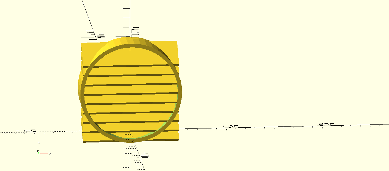

Dear all
what must I do to "cut away" the parts outside the tube ?
Thanks Karl

I think this is what you're looking for:
for (i=[0:10:w*10])
translate([0,0,i]) schraege();
  •    hull() translate([0,0,l/2-7]) xrot(90) tube(h=b, ir=(l-2)/2,
wall=4);}*

it works, when I add the part with the tube again after your proposal.
What I do not understand is  how hull() works here?? In the cheat-sheet
it is used with 2 circles.. I can imagine that hull () {object, object,
object}  draws a shape around to or more geometric parts... But here it
is used () "alone".
It works-- but I don't understand why :-|
Thanks for patience with an old man
Karl

In this case, hull() calculates the enclosing shape of a single object.
Dan

hull() makes the smallest convex object containing all its arguments.  With
a tube as the argument it fills in the inside to make a cylinder.  A more
direct solution to you problem is to intersect with a cylinder of the
appropriate size directly.

My simplistic take on this Karl- just wrap yours up in a union, then
difference another slightly larger tube.

My simplistic take on this Karl- just wrap yours up in a union, then difference another slightly larger tube. include <bosl2/std.scad> $fn=50; l=100; b=30; s=3; w=8; difference() { union() { for (i=[0:10:w*10]) translate([0,0,i]) schraege(); translate([0,0,l/2-7]) xrot(90) tube(h=b, ir=(l-2)/2, wall=4); } translate([0,0,l/2-7]) xrot(90) tube(h=b, ir=(l+6)/2, wall=20); } module schraege() { rotate ([40,0,0]) linear_extrude(s) square([l,b],center=true); }; On 2024-01-05 02:54, Karl Exler via Discuss wrote: > Dear all > what must I do to "cut away" the parts outside the tube ? > > Thanks Karl -- Cheers, Ken bats059@gmail.com https://vk7krj.com https://vk7krj.com/running.html ---------------------------------------- A baby can be defined as an ego with a noise at one end and a smell at the other. Your job as parents is to teach them to control all three. My job as a grandad is to tell you how you are doing it all wrong!

yeah... this is how my brain works.... thank you Ken.
and thank YOU Dan ;-)
KR Karl
