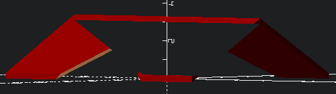

polyhedron difference renders ok but bad preview
MG
Matteo Gattanini
Sun, Feb 7, 2021 11:13 AM
I'm intersecting two polyedrons (I double checked their faces
definiftions), both taken singularly are previewed and rendered ok, but
when I difference them the preview fails from certain angles, while the
render is ok.
Am I missing something or could be a bug?

Hi, I'm intersecting two polyedrons (I double checked their faces definiftions), both taken singularly are previewed and rendered ok, but when I difference them the preview fails from certain angles, while the render is ok. Am I missing something or could be a bug? $vpr = [85, 0, 50]; //------------------------------------- module single_roof(dim, sp)    {     // P2  P8    p2 +-------------+ p3       P9  P3     //    \\        |      Y+     |           //     //     \\    p1 +-------------+ p4 ->X   //     //  P1 //P7     |      Y-     |       P10\\ P4     //    //     p0 +-------------+ p5        \\     // P0  P6                               P11  P5     p0 = [-dim.x/2, -dim.y/2, 0];     p1 = [p0.x, 0, dim.z];     p2 = [p0.x, dim.y/2, p0.z];     p3 = [dim.x/2, p2.y, p0.z];     p4 = [p3.x, p1.y, p1.z];     p5 = [p3.x, p0.y, p0.z];     p6 = [p0.x, p0.y, p0.z+sp];     p7 = [p1.x, p1.y, p1.z+sp];     p8 = [p2.x, p2.y, p2.z+sp];     p9 = [p3.x, p3.y, p3.z+sp];     p10 = [p4.x, p4.y, p4.z+sp];     p11 = [p5.x, p5.y, p5.z+sp];     points = [p0, p1, p2, p3, p4,  p5,               p6, p7, p8, p9, p10, p11];     // faces are defined by points indices (CW)     faces =        [         [ 0, 5, 4, 1 ], // Under Y-         [ 6, 7,10,11 ], // Over Y-         [ 1, 4, 3, 2 ], // Under Y+         [ 7, 8, 9,10 ], // Over Y+         [ 5,11,10, 4 ], // Side Y- X+         [ 4,10, 9, 3 ], // Side Y+ X+         [ 1, 7, 6, 0 ], // Side Y- X-         [ 2, 8, 7, 1 ], // Side Y+ X-         [ 0, 6,11, 5 ], // Side Y-         [ 3, 9, 8, 2 ]  // Side Y+        ];     polyhedron(points, faces);    } //------------------------------------- module single_roof_vol(dim)    {     dz = 0.001;     //  p2 +-------------+ p3     //     |      Y+     |     //  p1 +-------------+ p4 ->X     //     |      Y-     |     //  p0 +-------------+ p5     p0 = [-dim.x/2, -dim.y/2, 0-dz];     p1 = [p0.x, 0, dim.z-dz];     p2 = [p0.x, dim.y/2, p0.z];     p3 = [dim.x/2, p2.y, p0.z];     p4 = [p3.x, p1.y, p1.z];     p5 = [p3.x, p0.y, p0.z];     points = [p0,  p1,  p2,  p3,  p4,  p5];     faces =        [         [ 0, 5, 3, 2 ], // Under         [ 0, 1, 4, 5 ], // Over Y+         [ 1, 2, 3, 4 ], // Over Y-         [ 5, 4, 3 ], // Front X+         [ 2, 1, 0 ]  // Front X-        ];     polyhedron(points, faces);    } // Intersection difference()    {     color("DarkRed") single_roof([13,11,3], 0.3);     rotate([0,0,90]) single_roof_vol([12,6,3]);    }
     convexity
         Integer. The convexity parameter specifies the maximum number
of faces a ray intersecting the object might penetrate. This parameter is
needed only for correct display of the object in OpenCSG preview mode. It
has no effect on the polyhedron rendering. For display problems, setting
it to 10 should work fine for most cases.

Ehm, missed that, thanks a lot!
