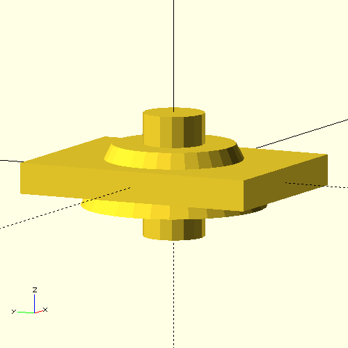

I’ve been thinking of a “stuff I always use” library for some time and now I’ve started one.
ccube(x,y,z) is now centred and without square brackets too. It had bothered me that “cube” required extra square brackets.
ccylinder(h,r) now doesn’t need r= , h= , just the numbers.
In “ccone”, the height now comes last, as in “cylinder”, to avoid confusion.
All that is missing now is a standard “blank.scad” with some “includes” at the top.
module ccube(x, y, z)
cube([x, y, z], center=true);
module ccyldr(r, h)
cylinder(r=r, h=h, center=true);
module ccone(r1, r2, h)
cylinder(r1=r1, r2=r2, h, center=true);
