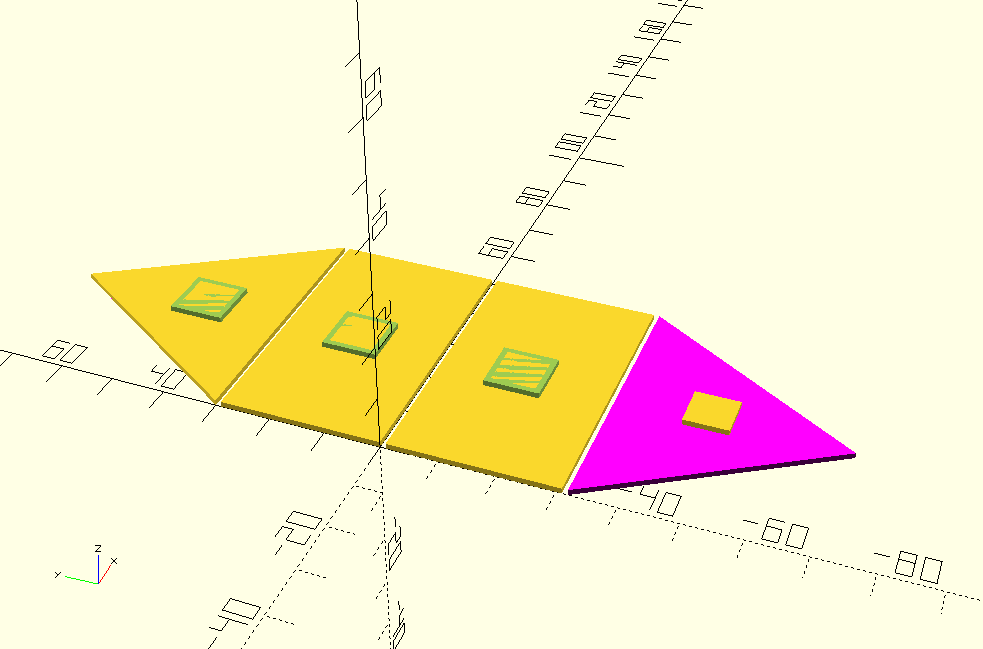

difference() issue. Any help would be appreciated.
DH
Dave Harris
Thu, Feb 3, 2022 8:12 PM
// test4objectsWithWindows.scad
// Each object has a window,
// cube & prism in +Y plane,
// cube & prism in -Y plane.
// Issue: -Y prism disapears.
module window(x, y, w, h)
translate([x, y, -1]) // punch out
cube([w, h, 3]);
module prism(h, lL, lR, w)
polyhedron(points=[
[0, 0, 0]    // 0 back LH corner
,[lL, h, 0]    // 1 back peak
,[lL+lR, 0, 0] // 2 back RH corner
,[0, 0, w]    // 3 front LH corner
,[lL, h, w]    // 4 front peak
,[lL+lR, 0, w] // 5 front RH corner
], faces=[
[0, 3, 5, 2] // bottom
,[0, 1, 4, 3] // LH ramp
,[1, 2, 5, 4] // RH ramp
,[2, 1, 0]    // back wall
,[3, 4, 5]    // front wall
difference() // +Y prism ...ok
translate([0, 30, 0])
prism(lL=25, lR=25, h=40, w=1);
window(x=20, y=40, w=10, h=10);
// show +Y cube window punch location
window(x=21, y=41, w=8, h=8);
difference() // +Y cube ...ok
translate([0, 0, 0])
cube([50, 29, 1]);
window(x=20, y=10, w=10, h=10);
window(x=21, y=11, w=8, h=8);
difference() // -Y cube ...ok
translate([0, -31, 0])
cube([50, 30, 1]);
window(x=20, y=-20, w=10, h=10);
// show -Y cube window punch location
window(x=21, y=-19, w=8, h=8);
difference() // -Y prism ... issue.
translate([0, -32, 0])
prism(lL= 25, lR=25, h=-40, w=1);
//window(x=20, y=-50, w=10, h=10);
} //comment out window, -Y prism is back
// show -Y prism window punch location
window(x=22, y=-52, w=8, h=8);
// preview/render - no error or warning
// eof
// Best regards Dave

Thu, Feb 3, 2022 8:16 PM
Looks like it is inside out:

Hi
Inside out?
I tried ...
translate([0, -32, 1])
prism(lL= 25, lR=25, h=-40, w=-1);
So the prism width is now -1... and it now works good!
Inside out? Can someone explain this strange concept!

Thu, Feb 3, 2022 10:22 PM
The faces of the polyhedron need to be listed in clockwise order
looking from the outside. If they are anticlockwise they are facing the
wrong way and will be coloured purple in the thrown together view.

Thu, Feb 3, 2022 10:40 PM
Many thanks for info
