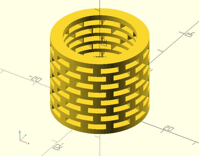

On 4/9/24 08:12, nop head wrote:
I have known Filaflex to fall to bits after a while. I switched the
Ninja for TPU and have not had any problems with that.
The roll I have has no label, The only roll of a bright blue I have.
Very glossy stuff on the spool, would need 3 days in a dryer before any
future use. Makes this part: handle_bunper.png, fits 3/4" oak dowel for
vise handle.
