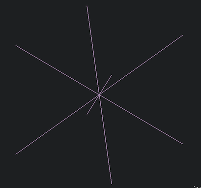

Sun, Jan 16, 2022 6:30 PM
[ crosshairs ]
I should have included a screen shot.

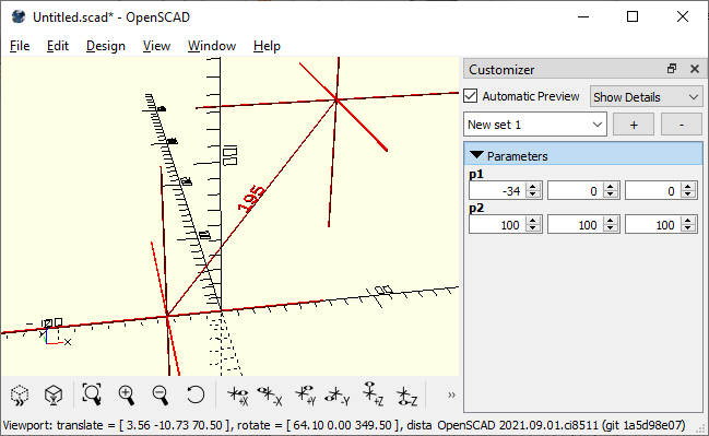

To a certain extent this can be done in the OpenSCAD program.  Positioning
the crosshairs is a pain in the neck, but doable.
Here's a sample program.  It will place two crosshairs, and draw a
dimension line between them.  You can control the location of the
crosshairs from the Customizer.
p1 = [0,0,0];
p2 = [100,100,100];
module crosshair(r, t=1) {
cube([r2,t,t], center=true);
cube([t,r
2,t], center=true);
cube([t,t,r*2], center=true);
translate(p1) color("red") crosshair(100);
translate(p2) color("red") crosshair(100);
color("red") dim3(p1, p2);
// Given an [x,y,z], transform to a
// [rho, theta, phi].
// Note that in mathematical spherical coordinates,
// phi is measured down from vertical.  This is as
// opposed to geographic coordinates, where latitude
// is measured up from the equator.
function topolar3(p) = [
norm(p),
atan2(p.y, p.x),
atan2(norm([p.x,p.y]), p.z)
module dim3(a, b, rot=0, h=10, d=1) {
r = d/2;
p = topolar3(b-a);
label = str(round(p[0]));
cone_r = r2;
cone_h = r
4;
translate(a) rotate([0,p[2],p[1]]) {
translate([0,0,cone_h]) cylinder(h=p[0]-cone_h2,r=r);
translate([0,0,p[0]-cone_h]) cylinder(h=cone_h, r1=cone_r, r2=0);
cylinder(h=cone_h, r1=0, r2=cone_r);
rotate([0,-90,0])
rotate([rot,0,0])
linear_extrude(height=r
2, center=true)
translate([p[0]/2,r*1.2,0])
text(label, size=h, halign="center", valign="bottom");
