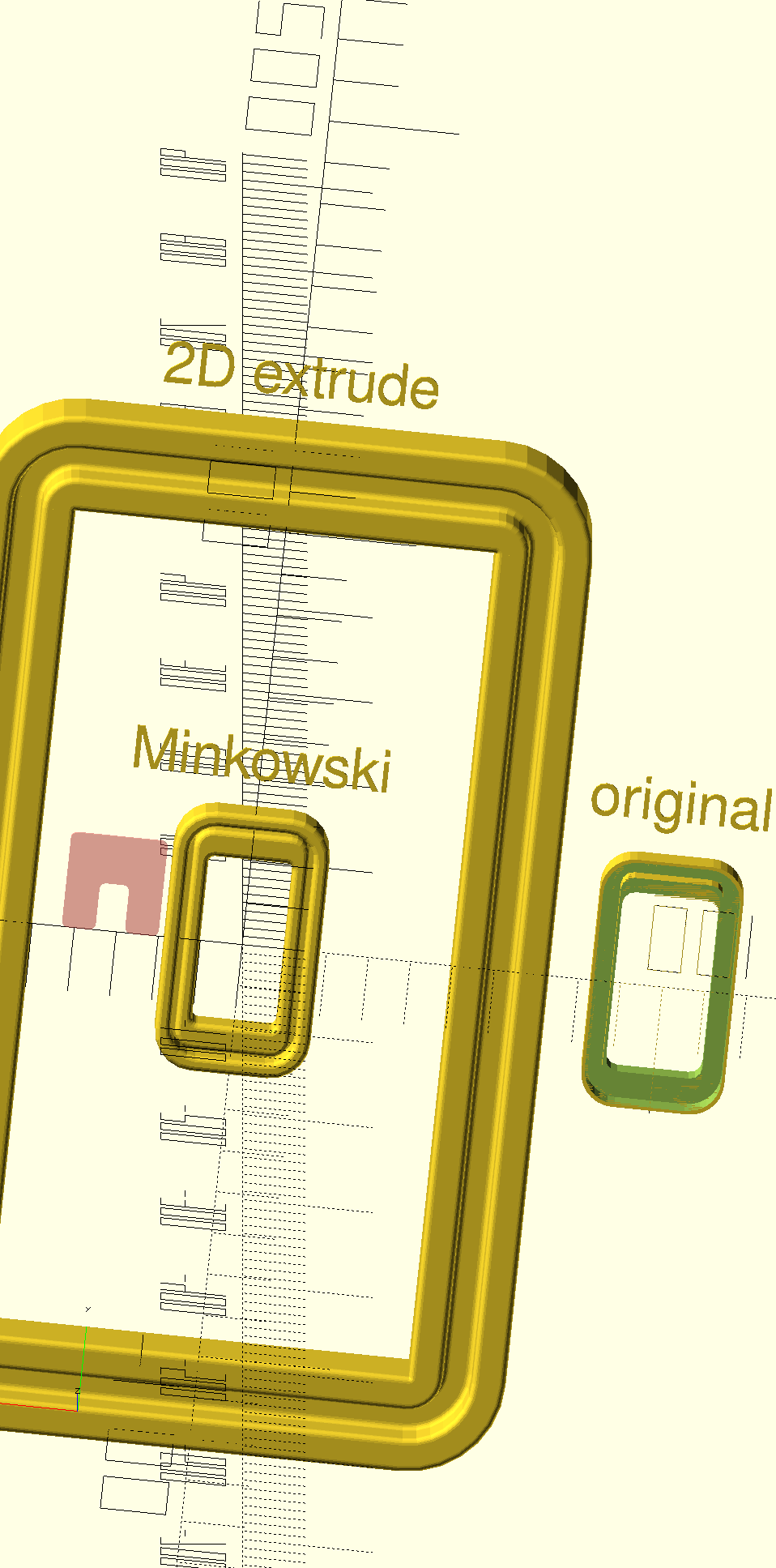

Hi Bob,
Is my understanding ouf your desired shape correct?
Maybe you could like one of the attached examples. I used a 2D-shape and liner_extrude/rotate_extrude to create a sample.
Cheers,
Marcus

Hi Marcus,
Thank you for your efforts.  The pieces look very nice and close to what I am wanting.
The bottom cannot be rounded because it mates with a part on the camper and the dimensions have to all be adjusted because of the mating.
I printed some using my design and the edge is not as sharp as I thought it would be and the campers are wanting a solution now.
Thank uyou,
Bob
