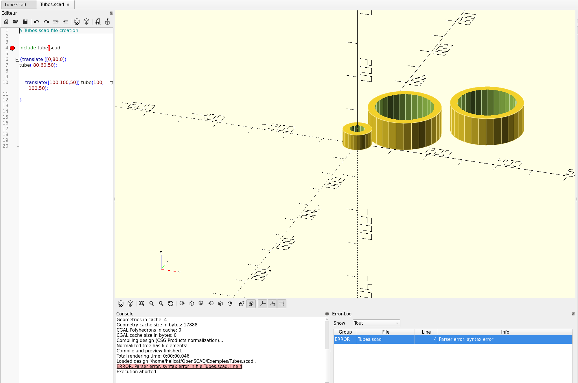

Hi all,
I'm learning OpenScad, and can't fix following error message:
ERROR: Parser error: syntax error in file Tubes.scad, line 4
Replacing semi-colons, curly brackets, square brackets, and always the same message...
Googling a lot and not how to fix it.
Is there someone kind enough to tell me, where is the mistake?
Thanks a lot, and nice day.

include <tube.scad>
No semicolon. Yes, that's confusing and I mess it up on a regular basis.

On 11/18/2024 6:26 PM, Father Horton via Discuss wrote:
include <tube.scad>
Perversely, it's not weird enough.
"include" is not a normal statement.  The text of the file is included
in the program, as if it was typed there.
Have a comma-separated list of values that you need in an array?
array = [
include <commavalues.txt>
Have a value in a file that you need in a variable?
x = include <value.txt>;
Quick, exactly what does this do?
include = 5;
if (include < 10 && include > 3) cube();
There are only a very small number of places where include<> is not
recognized:  inside a string, inside a comment, inside a larger
identifier, and inside the integer part of a number.
The behavior of the include<> construct is special enough that it would
really be better if it had some special marking, like #include does in
C.  It should also only be recognized if on a line by itself; there's no
need for the obscure ways you can abuse it.
Its friend use<> is slightly less magic, but only slightly.
To be clear:  I'm not saying that include<> behavior is good.  Quite the
contrary, in fact.  But if you expect it to be normal, you'll be
surprised and confused.

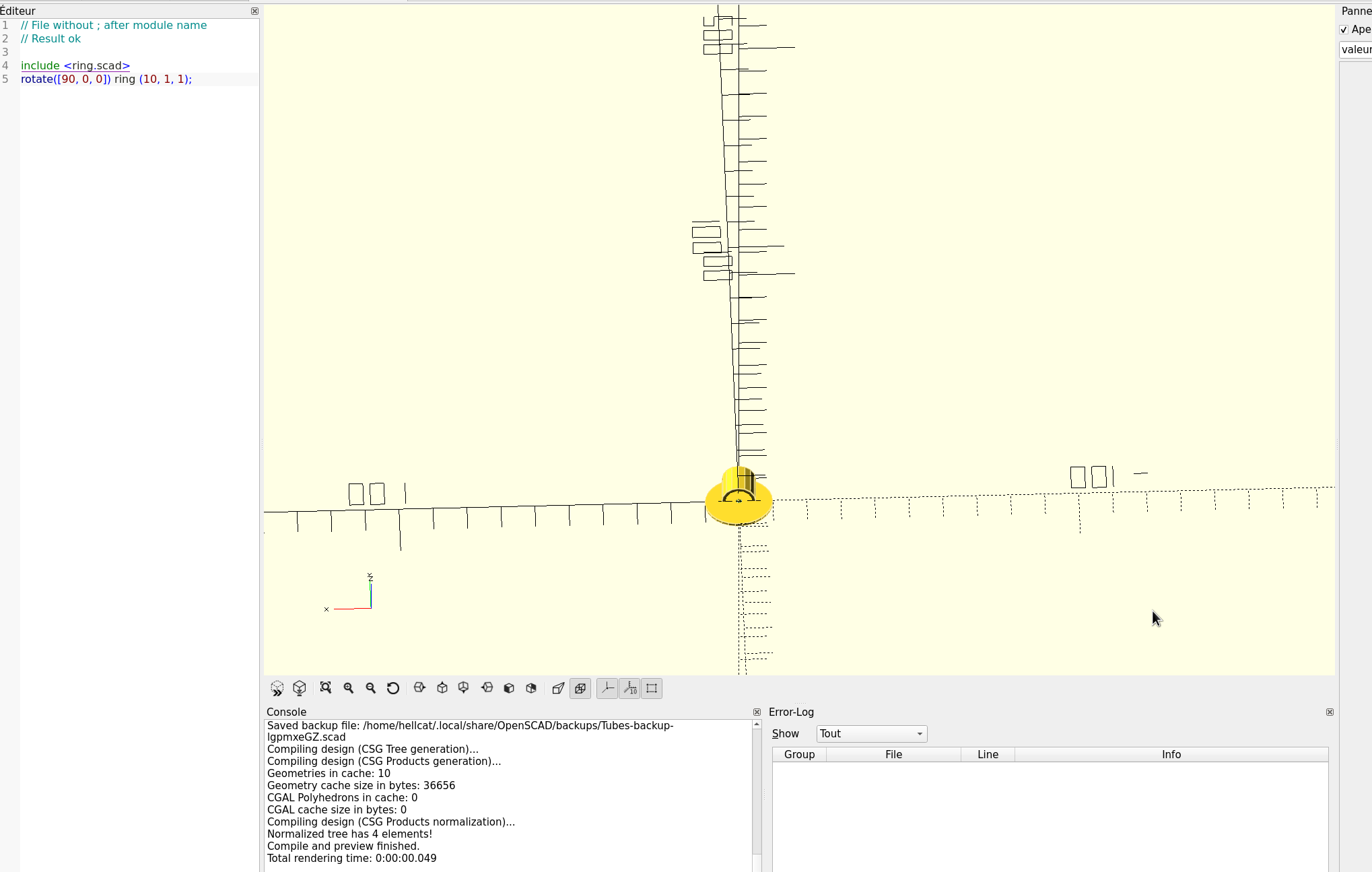

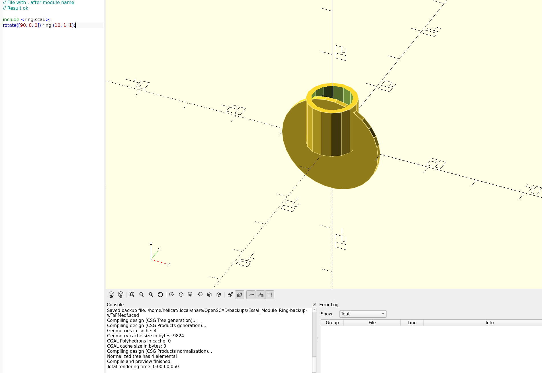

Hi all,
As i never give up, i did numerous  trials, and find the result…
In a shortcut, include seems to accept ; !!!!
If ; is missing doesn’t matter, it’s strange.
See screenshots .
Nice day, and thanks for your help in this forum.
jm

Hi Jordan,
You are right, missing < and> in this statement.
Nice day and thanks a lot.
jm
