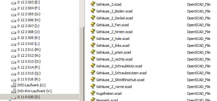

Hello,
now it's use- Since the whole case is a great object I made it with some functions. Each of
them is for one part (like bottom or the right wall). Each is plate with cut-offs or so. So each
will be printed alone with an orientation possible different to the orientation used in the
project. So hang-over parts or so are reduced. As all of the modules are in one file it works
fine but if the files are different and concatuated through use-commands it works not. There
is no error but there is no device at all.
That's the whole-case file. Only two comments are missing
[code]
use <Z:\Gehäuse_2_Boden.scad>;
use <Z:\Gehäuse_2_Deckel.scad>;
use <Z:\Gehäuse_2_links.scad>;
use <Z:\Gehäuse_2_rechts.scad>;
use <Z:\Gehäuse_2_vorne.scad>;
use <Z:\Gehäuse_2_hinten.scad>;
use <Z:\Gehäuse_2_prism.scad>;
use <Z:\Gehäuse_2_hole.scad>;
use <Z:\Gehäuse_2_Schraubklotz.scad>;
use <Z:\Gehäuse_2_SKmitEinschub.scad>;
use <Z:\Gehäuse_2_Fan.scad>;
// Mutterkuhle .... Größe
Mutter=5.5;
translate([-43,-90,0]) {
    Boden();
    WandLinks();
    WandRechts();
    Deckel();
	WandVorne();
	WandHinten();
[/code]
A part of the directory of 'Z' is as appendix added. All of the files are really there. So: what's
wrong here? I can't find the error.
greetings
Manfred

Try to rename your file and avoid using German Umlaute like "ä".

no global varables but it was really the 'ä'. That's surprising to me since we have unicode. But
it is this way.

You are using Windows, and OpenSCAD uses UTF-8 internally. Windows by
default does not correctly support UTF-8. You might be able to make this
work by changing the Windows code page to 65001 before running OpenSCAD.
Apparently the CLI command "CHCP 65001" will do that. But I haven't tested
this.

Yes, file system access needs to convert the filename, the content
of the file is defined to be UTF-8 always.
So the filename specified in the include/use statement must be
UTF-8 encoded (and the internal editor should enforce that).
If the file is edited with a different editor and saved in some
other encoding, things will break (and in that case it would not
be a bug in the application).
I guess we need to find out if the reported issue is a bug or
wrong file encoding.
