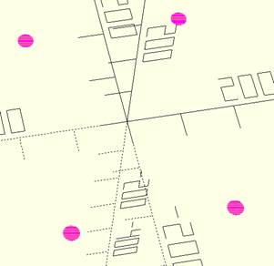

Hi all,
This produces the correct result, 'lilypads' at all 4 corners of an A3 sized
3D print.
for(i=[-0.5,0.5],j=[-0.5,0.5])
            translate([297*i,420*j,0])
                            cylinder(0.2,15,15);

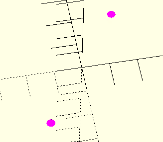

However this, which I tried first, did not work, and shows only 2 corners:
for(i=[-0.5,0.5])
            translate([297*i,420*i,0])

The for loop is iterating through a list with two elements, -0.5 and +0.5
so it will only create two objects, no matter what you do with the result.
Not sure why you would think otherwise. If you use i in both the x and y
expressions it has the same value for one iteration and the second value
for the other.
To make four holes with one loop perhaps you rotated by 90 degrees, or
indexed a table to get independent x and y values. The straight forward way
is to use two variables as your first example. It has always been like that.

i = [-0.5,0.5];
j = [1,2,3];
for (i=i,j=i)
  •            translate([20*i,40*j,0])*
  •            cylinder(0.2,5,5);*
Results in:

india = [-0.5,0.5];
juliet = [1,2,3];
for (i=india,j=india)
             cylinder(0.2,5,5);
Gives you..
So even though in the for() variable, we first say that i (within the for
loop) is i (as defined earlier), saying j=i does not result in an output
matching either instance???
I find that a bit odd.  No doubt there is a sensible reason for this!

The same sort of thing is happening, but we need to look at it even more
carefully.
i and j start out as the two vectors.
Then a new i is created to step across the old i.
Then a new j is created to step across ... the new i.  By the time that
the j=i is examined, the original "i" containing a vector is no longer
visible; what is visible is the current value of i as we step along the
vector.
Mostly, just don't do this kind of thing.  It will hurt your brain.
india = [-0.5,0.5];
juliet = [1,2,3];
                translate([20i,40j,0])
                cylinder(0.2,5,5);
Right.  Because nothing is replacing "india".  i steps across india (a
vector of two elements), and for each of those elements j steps across
india.  (Note that nothing looks at juliet.)
