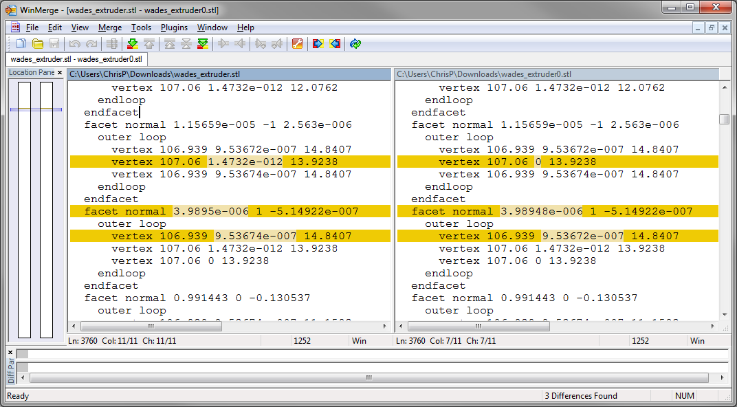

When you have a large fully parametric design and you change something it
isn't always obvious what the knock on effects will be. But you need to
know exactly which STL files have changed so you can re-slice and reprint
them. Also when you make a change to accommodate a new variant you might
want to verify that it doesn't affect other variants.
In both of the above use cases you need to be able to compare the STL files
and know if they have changed. As discussed before OpenScad uses machine
addresses to order the vertices, so the order changes when you change
unrelated code. I got around this by writing a Python script to order the
vertices numerically. That works most of the time but I still get the odd
file changing unexpectedly.
I changed a module today that generates rounded cylinders. The change
shouldn't have actually affected anything at all because mathematically it
was the same shape. However it did make small changes to STL files that
used it. Fair enough, probably due to the numerical conversion issues
discussed yesterday. However, it also changed an STL file that does not use
it. It includes the module but does not invoke it.
The change is numerically insignificant but it makes very difficult and
time consuming to work out what has really changed. Only two vertices
changed out of a file nearly 1MB long.
[image: Inline images 1]
Is it possible that having the vertices ordered by address (which can
change from machine to machine and when anything is added to or removed
from the source code) can lead to different numerical results due them
being processed in a different order somewhere?
Oddly although GitHub's STL difference views shows the correct number of
lines changed, it highlights a lot more triangles, so I think it has non
deterministic issues as well.

Was the old STL done with the same OpenSCAD version?
Doesn't sound good for geometry to change where a changed module is not
invoked.
I still have a feeling there is a ghost in the machine since 2015.03...
Yes the same 32 bit binary but running on 32 bit XP on a core due as
opposed to 64 bit Win7 on a core I5.
invoked.
I am not sure that is the case, I may have been mistaken or it is a very
rare occurrence.
Yes the same 32 bit binary but running on 32 bit XP on a core due as opposed to 64 bit Win7 on a core I5.
That would be on a different CPU, different OS and different C library implementation, all of which can influence floating point arithmetics as well as rounding.
If you really want 100% parity across CPUs, OSes and C libraries, I would start by investigating two things:
  1. Rounding, see e.g. http://martinwguy.co.uk/crunch/test/tybor/tbin2dec.c
  2. Floating point format used (e.g. 80 bit float extensions which has been discussed earlier)
Note that this will probably extend to the external libraries we use as well (CGAL, Eigen, libtess2, Clipper).

tbin2dec.c prints the same on both computers when compiled for 32 bits with
GCC 4.9.2. It also prints the same when compiled for 64 bits on the 64 bit
OS.
Rounding is add 0.5 and truncate.
MIN_WIDTH=509.
