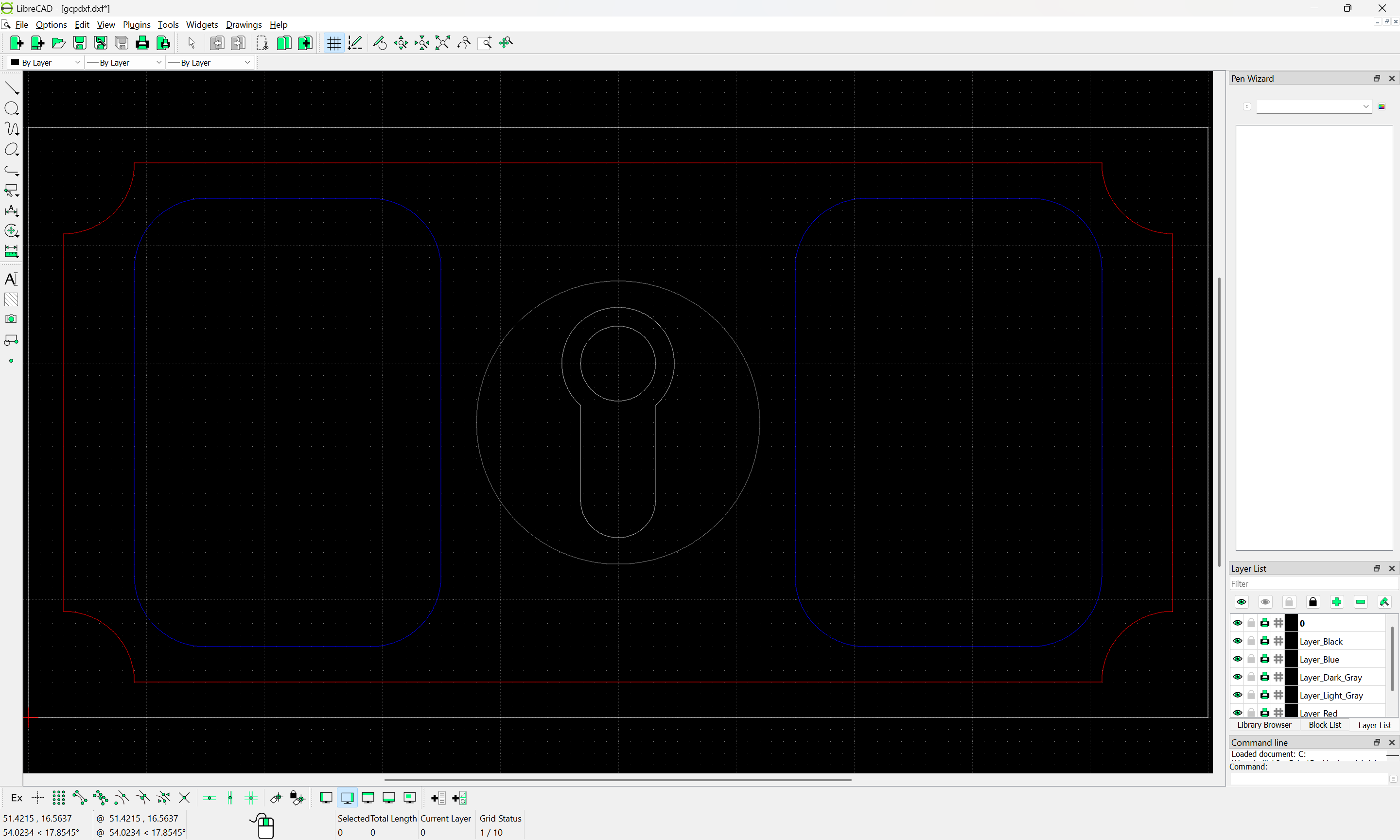

William F. Adams
Sat, Apr 26, 2025 2:16 AM
Took a stab at this for DXFs in OpenPythonSCAD, and have a file:
https://github.com/WillAdams/gcodepreview/blob/main/gcpdxf.py
which makes a DXF (see attached DXF) which has multiple colors (see attached screengrab showing the DXF open in LibreCAD).
Usage is:
Install OpenPythonSCAD from: https://pythonscad.org/ (for Windows I would suggest the older build: https://www.pythonscad.org/downloads/PythonSCAD-2024.12.29-x86-64-Installer.exe until there is an updated version which fixes Library import for Windows).
Download the .zip archive of the gcodepreview files: https://github.com/WillAdams/gcodepreview/archive/refs/heads/main.zip and unzip it, and copy the files gcodepreview.py and gcodepreview.scad into the folder revealed by PythonSCAD | File | Show Library Folder (for my account this was: C:\Users\willa\OneDrive\Documents\OpenSCAD\libraries) then open a template file and use it as a guide to make the file which you want.
The file gcpdxf.py shows making a color DXF which requires just a few commands, notably gcp.setdxfcolor("Black/Red/Yellow/Green/Cyan/Blue/Magenta/White/Dark Gray/Light Gray") --- there is an OpenSCAD version, "setdxfcolor("<color name here>"); and one can coordinate the DXF geometry with the 3D model.
If anyone has trouble making a file, send me a .scad file and let me know the specifics of the DXF which you would like to see and I'll work up an example.
