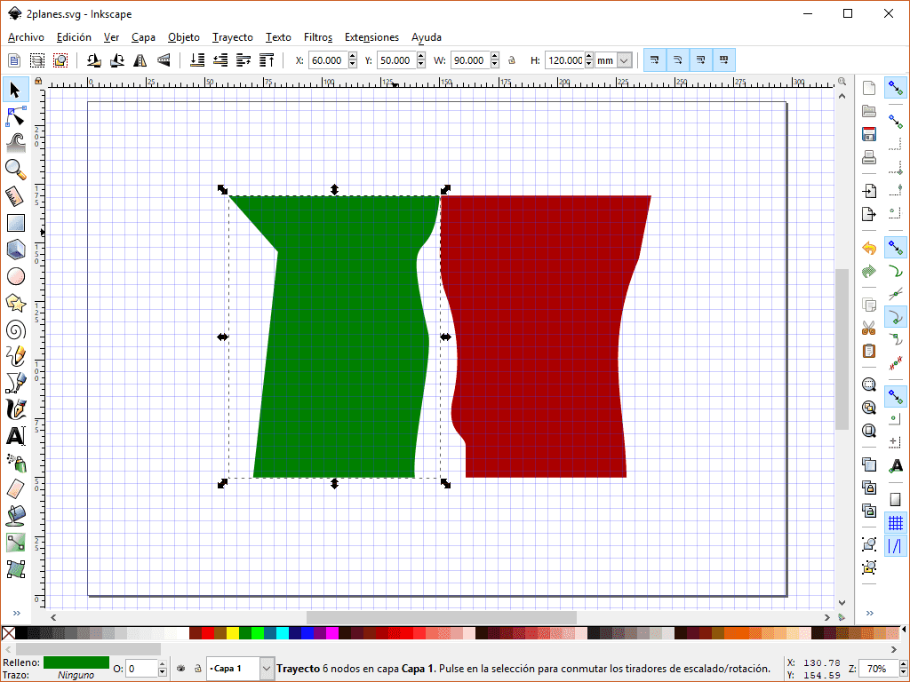

First, a couple of shapes: imagine the "weird vase" cut by the XY and the
YZ planes
[image: Imágenes integradas 1]
One of the shapes must be copied and mirrored
[image: Imágenes integradas 2]

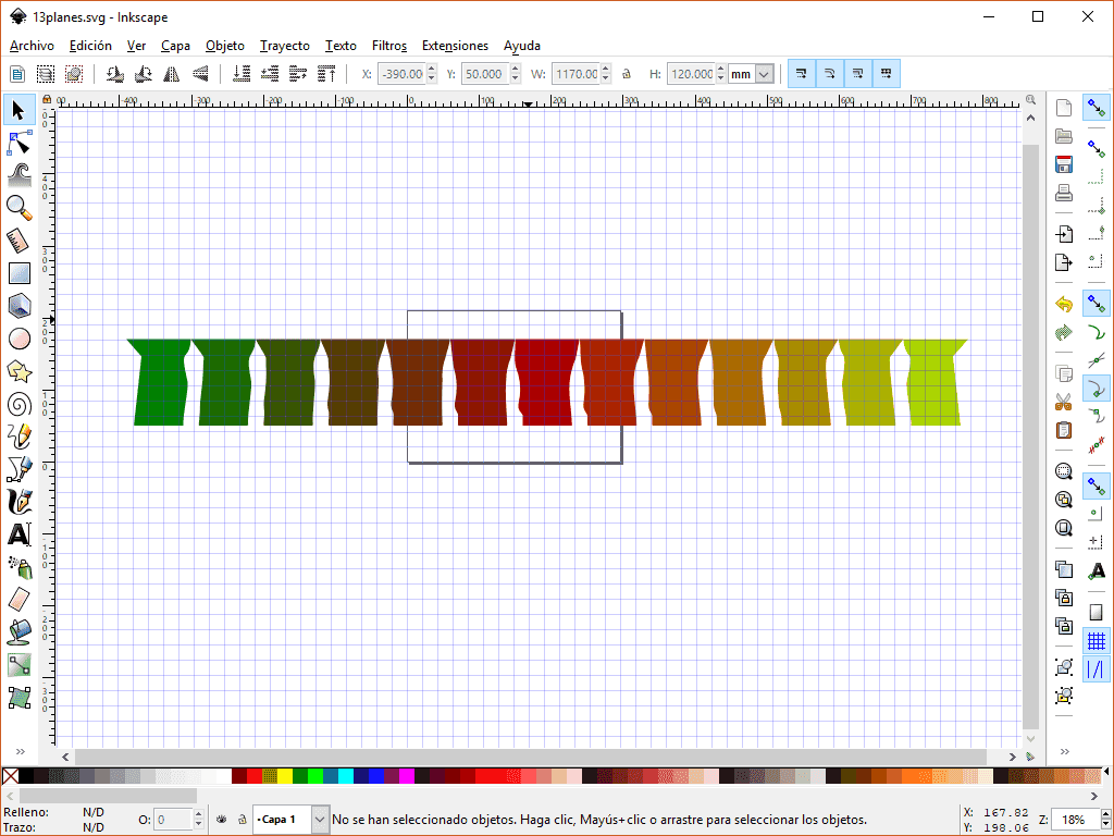

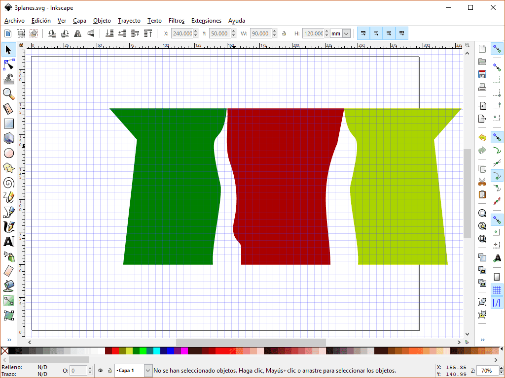

Then a couple of Inkscape's path interpolations, and save as SVG
[image: Imágenes integradas 3]

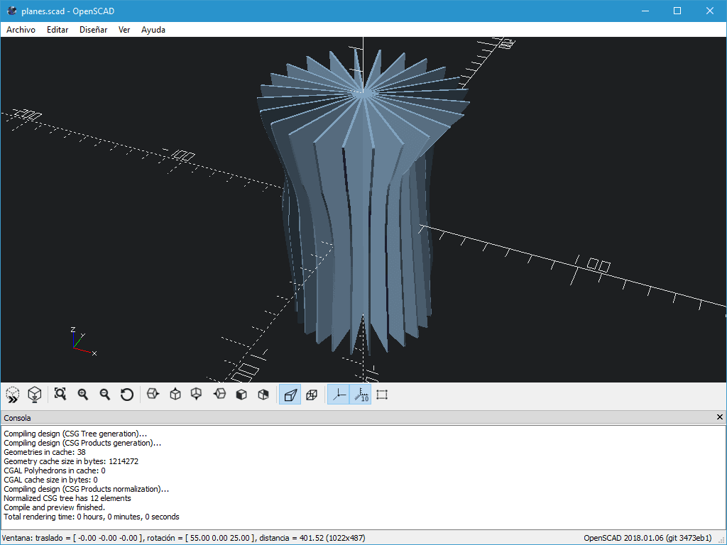

Importing the SVG file into OpenSCAD we can arrange the "planes" like this
[image: Imágenes integradas 4]
And cutting vertical slices and "hulling" each of them ends up like this
[image: Imágenes integradas 5]
This is the code:
width = 90;
height = 120;
planes = 13;
module plane(n) {
linear_extrude(height=1, center=true) intersection() {
translate([width*(n-floor(planes/2)), 0]) import(str(planes, "planes.svg"));
square([width, height], true);
module planes() {
for(i=[1:planes-1]) rotate([90, 0, 180/(planes-1)*i]) plane(i);
for(i=[-height/2:height/2]) hull() {
planes();
translate([0, 0, i]) cube([width, width, 1], true);
The attached file includes the .scad, the .svg and a rendered .amf
2018-02-16 18:52 GMT+01:00 jon jon@jonbondy.com:
Thanks for the n-point Bezier code!
