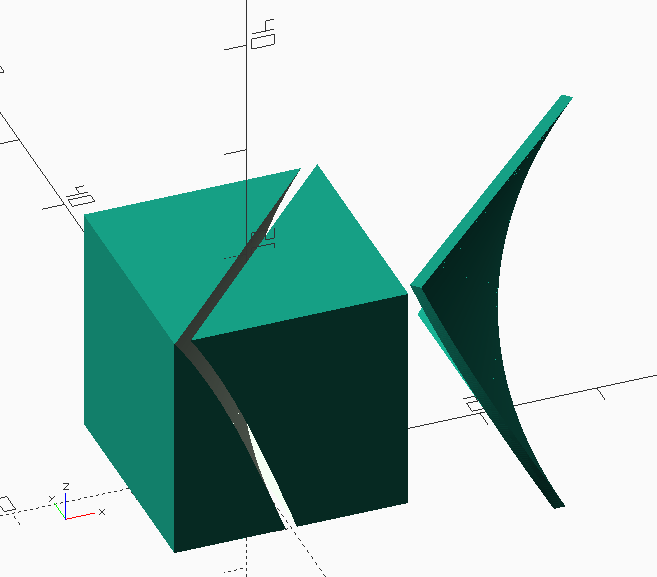

I'm having a problem using difference() with an object I created with
linear_extrude(). The extruded shape is different and wrong when it is used
in difference() than when it isn't used in difference(). The example code
extrudes a rectangle with twist. When it is extruded by itself, the shape is
correct. When the extruded shape is subtracted from a cube using
difference(), the shape is incorrect. The sides are jagged and the top is
too narrow in the middle. I'm using OpenSCAD 2019.05 on Windows 10.
Example images:  top_view.JPG
http://forum.openscad.org/file/t1635/top_view.JPG    side_view.JPG
http://forum.openscad.org/file/t1635/side_view.JPG

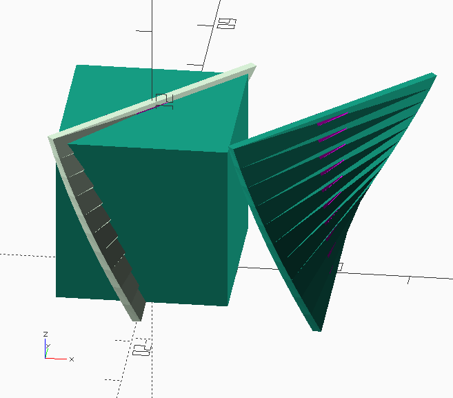

If you look at the thrown together view you will see this.
The section is so twisted compared to the number of slices it
self intersects and the purple bits are inside out. If you increase the
slices to 100 it looks OK.

Tue, Aug 18, 2020 4:04 PM
Well everything is jagged in OpenSCAD, there are no curves. The twisted
shape has facets made of two triangles at an angle, that give it a rippled
surface. If you zoom you can see the ripples and that gives the jagged edge
when subtracted.
There is nothing wrong with difference().

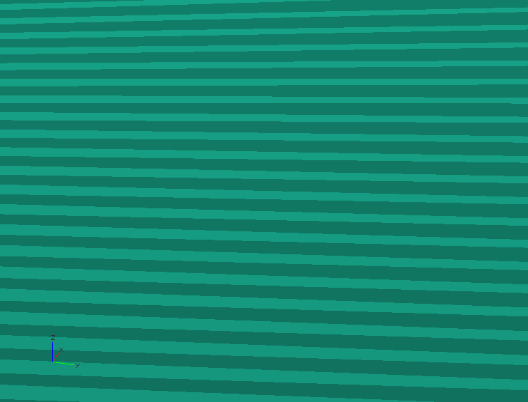

Tue, Aug 18, 2020 7:59 PM
The shape does have z-zag edges. This is what it looks like away from the
edges when zoomed in.
The shape is larger than the block so it cuts away from its edges, where it
is smoother.
