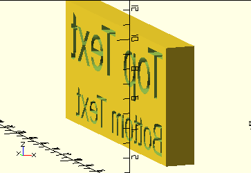

I have the following code that is partially working the way I'd hoped.  If I
run only companyName(), I get what I want (an indented area with raised
letters).
When I try to difference it from a cube, it becomes letters etched into a
two dimensional rectangle positioned away from the cube.
My goal is to be able to create a reusable text block that I can imprint on
my parts.  I want this to be raised text in a recessed rectangle.
Any help would be most appreciated!

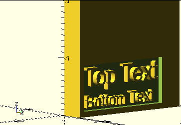

Here's what you want companyName() to produce:
Note that this scheme is based solely on differencing - you cannot use
it to make text that will extend outside the original "big cube".  Doing
that would require removing the inset as one step, and then adding the text.
Here's what you need.  All I've done is to remove cube A and move the
text inside the difference() so that it's being subtracted from cube B.
Oh, and I renamed "notWorking" to "nowWorking" :-)

Like so:

come together in one module, so you want to algebraically transform it
to (bigcube - (negative - text)).
It doesn't quite work like arithmetic, but it's close.  In arithmetic,
a double negative is a positive.  A-(A-B) is equal to B.  In OpenSCAD
CSG, a result can never be negative, so A-B can be anything from zero
to A and A-(A-B) can't be more than A.  Strictly, it's set
differencing rather than arithmetic differencing.
You need to be subtracting the inset, except the text, like so:
     cube();    // big cube
         cube();   // negative
         linear_extrude() text();
Note that your first cube, the one I labelled "positive", is not
required.  It's material that you expect to remain from the object
being imprinted; it isn't part of the "negative space".
Sigh.  I changed the labels as I wrote the message, and missed one.
Should be "Note that your first cube, the one I labelled A, is not
required".
Doing that would require removing the inset as one step, and then
adding the text.
B.  Oh, and I renamed "notWorking" to "nowWorking" :-)
 use <fontmetrics.scad>;
 module companyName(x, y, z,height) {
     textDepth=1;
     border=1;
     textSpacing=.5;
     usableHeight=height-2*border-3*textSpacing;
     topTextHeight=usableHeight/2;
     bottomTextHeight=usableHeight/3;
     font = "Arial";
     topText = "Top Text";
     bottomText = "Bottom Text";
     topTextLength = measureText(topText, font=font, size=topTextHeight);
     bottomTextLength = measureText(bottomText, font=font, size=bottomTextHeight);
     echo("topTextLength", topTextLength);
     echo("bottomTextLength", bottomTextLength);
     translate([x-2*textDepth,y,z]) {
             translate([textDepth,border, border]) {
                 if (topTextLength > bottomTextLength) {
                     cube([2*textDepth, topTextLength+border+textSpacing, height-2*border]);
                 } else {
                     cube([2*textDepth, bottomTextLength+border+textSpacing, height-2*border]);
             translate([textDepth, border+textSpacing, height-border-topTextHeight-textSpacing]) {
                 rotate([90,0,90]) {
                     linear_extrude(textDepth)
                     drawWrappedText(topText,font=font,size=topTextHeight,halign="justify");
                     //text(text, size=topTextHeight);
             translate([textDepth, border+textSpacing, border+textSpacing]) {
                 rotate([90,0,90]) {
                     text(bottomText, size=bottomTextHeight);
 module nowWorking() {
        cube([4, 50, 50]);
        translate([0.01,-0.01,-0.01]) companyName(4, 0, 0, height=10);
 module working() {
 nowWorking();
Like so:
