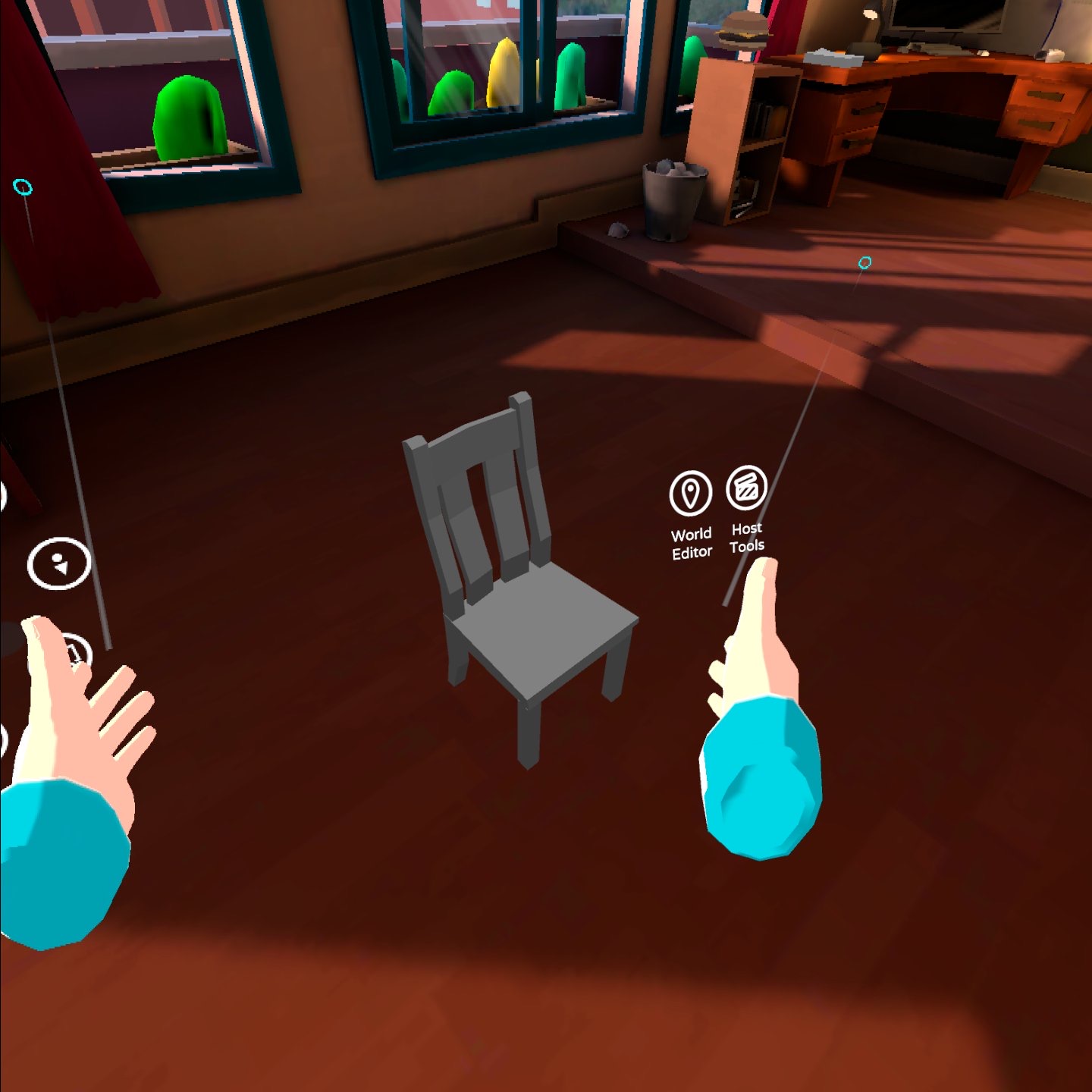

It's actually remarkably simple to get a primitive result.
Use OpenSCAD to generate an STL.
Load your STL into Windows' Paint 3D.
Save it as a *.glb file.
Follow the instructions at
https://docs.microsoft.com/en-us/windows/mixed-reality/altspace-vr/world-building/importing-models
And poof!  This gray chair is an OpenSCAD model inside the AltspaceVR
environment on my Oculus Quest 2.
There are a couple of gaps to fill, some on the model side and some on
the AltspaceVR side.
  • It's gray.  Perhaps I could paint it in Paint3D.  (But what I really
    want is multi-color / multi-material support in OpenSCAD.  Maybe I
    can make enough time to take a stab at that...)
  • It would be nice if OpenSCAD could write the .glb directly.
  • It doesn't have physics.  In fact, despite having "collidable" set
    you can walk through it and drop things through it.  AltspaceVR has
    physics; you can have objects that fall and bounce when you drop
    them.  But models imported this way don't, and I don't see any way
    to enable it.  It might be necessary to take the model into Unity
    and give it physics there, but I'm still in my very first Unity
    tutorial.  I don't know about importing stuff into Unity, and I
    don't know about moving stuff from Unity into AltspaceVR.
