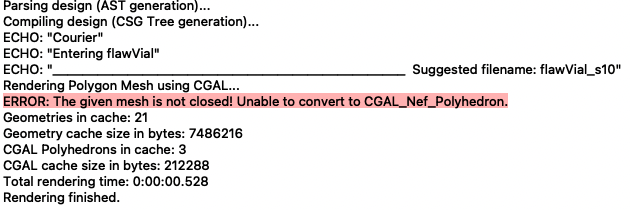

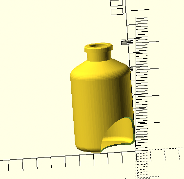

Hello,
I am modeling flaws in the production of glass vials.  One of the techniques I’m trying subtracts “flaws” from the original .stl with difference().
This first (exaggerated) example works (to demonstrate what I’m after):
module test () {
// remove a sphere from the vial
import(pFilename);
#sphere(r=25);
However, with a differently produced .stl (which loads and renders fine on its own in OpenSCAD), the following error is reported:
Pardon me if this is a dumb question, but shouldn't a solid removed from a closed mesh, itself be closed?
(I’d like to include the .stl that fails, but am not clear how to do that with the mailing list.)
Thanks for any insight,
Greg

This is likely the result of some edge case where there are coincident or
near coincident faces being subtracted from each other. At least that is my
guess
Not necessarily, but if they overlap by a finite amount and don't share
edges or faces it should be. The most likely cause is the original STL is
not a valid solid. OpenSCAD won't tell you until you try to do a boolean
operation on it.
