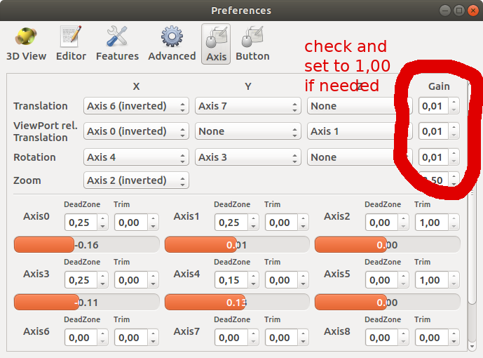

Am 31.01.2018 um 23:29 schrieb Torsten Paul:
This seems to be a bit of an old build, that contains a known bug.
You have to set the gain for the axis manually to 1,00, as the default
gain is 0,01:
Unfortunately, this is also written to the preference file, meaning the
bug affects/transfer to other instances.
With Kind regards,
Michael Frey

Am 01.02.2018 um 19:34 schrieb sibjo:
2: None of the settings under "Axis Mapping" seems to have any effect so I'm
guessing the settings are stored somewhere else. I had a quick look in
SpaceNavInputDriver.cc but I don't want to mess with anything I don't
understand. Where do I lower the sensitivity?
The spaceNavInputDriver is not using the axis mapping feature.
The spaceNavInputDriver is directly effecting translation and rotation
of the view.
Therefor, I currently also do not know how to adjust the sensitivity
when using the spaceNavInputDriver.
3: This is related to number 2 - I did a quick test in Blender with the
SpaceNav deamon installed. Any chance I can configure SpaceNav to work the
same way in OpenSCAD? (move the camera, not the object)
When using the spaceNavInputDriver: No.
When using other drivers that are using our Axis Mapping: Sure.

Thanks for your help guys! Now I'm finally getting somewhere :) I first tried to change some privileges but after a while I just searched and deleted everything related to OpenSCAD and recompiled it and now the settings work without being root. >Are the axis indicators moving? I had to restart spacenavd >at some point. It might not be possible to connect to spacenavd >if another application is using it (or another instance of >OpenSCAD). It's a little strange because I can use the SpaceMouse to move (however it's crazy sensitive) but when I'm in preferences the axis indicators are not moving. Axis mapping settings don't change anything. >When using other drivers that are using our Axis Mapping: Sure. >I used to use the 3D mouse for openscad with the HidAPI Driver, but starting OpenSCAD with sudo just to >use the HidAPI driver really is not a good solution. (the Linux HidApi Driver is more meant for developers, >so that we do not need to cross build the windows version.) Good news then! I agree with you on running OpenSCAD as root is a bit of a PITA but I tried HidAPI anyway. The axis indicators are moving with HidAPI and the setting for axis mapping actually works! Well, almost... I got it to work kind of like I want except that the "ViewPort rel. Translation"-settings doesn't work at all which is sad because I'm almost getting there. About the Buttons: >Maybe those are not handled by spacenavd, or we need to >do something else to support them. This is tricky to solve >without access to the hardware. Maybe we can try some >debugging later once the main features are working. After recompiling I got some strange news: no more highlights at all. No matter what drivers I have activated I'm not getting any response from any button anymore. weird.. / Simon -- Sent from: http://forum.openscad.org/
OpenSCAD).
The SpaceNavDriver is ignoring the settings. The SpaceNavDriver is
directly affecting the ViewPort.
Meaning: When you are using the SpaceNavDriver, the axis mapping has no
effect and the axis indicators have no function.
(I do not know whether this is a feature, a bug or an artifact from the
early development phase)
of a
getting there.
Could you please be more specific? Maybe we need yet an other kind of
translation.
The feature works for my use case (left thumbstick of a XBox360
Controller controlling the camera). I have one axis of the stick mapped
to ViewPort rel. Translation X and the other to Z.
ViewPort rel. Translation on Y has no effect when you are in orthogonal
view ().
When you are in perspective view (), the effect of "ViewPort rel.
Translation on Y" is similarly to zooming, but in a very strange way.
That the two relevant axis are X and Z  (and not as a user might think X
and Y) has to do with the internal working of openSCAD.
Maybe we should hide the option to configure the "ViewPort rel.
Translation on Y".
(but as a developer, I have the tendency to leave in any potentially
useful feature - "ViewPort rel. Translation on Y" combined with the Zoom
can be used for a vertigo effect, which can be used to precisely match
the perspective of a photo with a render)
