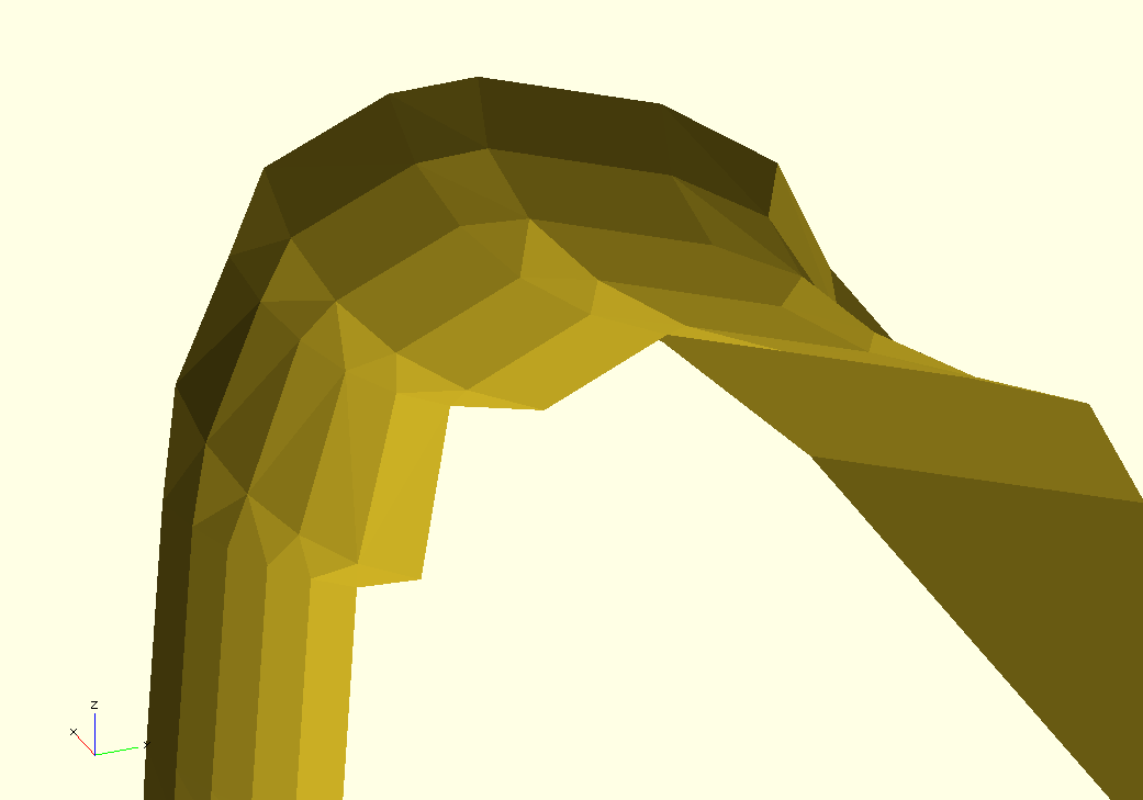

I was looking more closely at the fillet between the U-bar and sphere,
and it appears that there is a funny irregularity.  I'm not sure what
is going on, but it looks like there is a jagged top edge and some
non-smooth areas on the fillet.  Perhaps the faces are being defined
incorrectly with an off-by-one error?  (Maybe this explains so many
warnings.)  I attach a picture showing the fillet by itself below.
Can you make a connection between two arbitrary prisms?  (Seems like
the base prism would need to be convex.)  I'm intrigued by this.  It
may inspire me to write something of my own.  In principle a parallel
connection is OK---the fillet is a trivial straight line segment.
It's when you have no connection that you're really in trouble.

I was looking more closely at the fillet between the U-bar and sphere, and it appears that there is a funny irregularity. I'm not sure what is going on, but it looks like there is a jagged top edge and some non-smooth areas on the fillet. Perhaps the faces are being defined incorrectly with an off-by-one error? (Maybe this explains so many warnings.) I attach a picture showing the fillet by itself below. Can you make a connection between two arbitrary prisms? (Seems like the base prism would need to be convex.) I'm intrigued by this. It may inspire me to write something of my own. In principle a parallel connection is OK---the fillet is a trivial straight line segment. It's when you have *no* connection that you're really in trouble. On Sat, Jan 22, 2022 at 11:58 AM Sanjeev Prabhakar <sprabhakar2006@gmail.com> wrote: > > Thank you so much for your kind suggestions. > I will try and improve on code readability and also the warning thing > > Limitation of the function "ipf (intersection point for fillets)" is when the intersection angle is near parallel between the 2 intersecting solids, it doesn't work. > Logic used: > First identify the intersection point between the 2 solids (first one is the solid which is intersected with and the 2nd one intersecting the first one). > from these points trace the points and create the fillets. > I have tried in few cases and most of the cases it worked, where the intersection lines are making an angle which is greater than 20 deg, best would be 90 deg. > > > > > On Sat, 22 Jan 2022, 21:54 Adrian Mariano, <avm4@cornell.edu> wrote: >> >> The fillets looks nice. How does your code work and what can it >> actually do? What are its limitations? It looks like there is a >> sphere-sphere routine and a cylinder-cylinder routine? You might >> consider a more readable and documented coding style for your >> libraries if you are going to give your code to others. Having all >> your top level functions be cryptic 2 and 3 letter names makes it hard >> to even guess what's going on. >> >> The fillet connecting the U-shaped beam to the sphere is missing a row. >> >> Also, I think the tons of warnings are slowing your code down quite a >> bit. It would be a significant improvement if the code didn't >> generate warnings. I strongly encourage you to do the following: Go >> to Preferences->Advanced and select "Stop on first warning", near the >> bottom of the list. This turns warnings into fatal errors and will >> force you to fix the warnings. It also makes it easier to fix them >> since you don't get 200 warnings any more, just the first one. >> >> On Sat, Jan 22, 2022 at 10:54 AM Sanjeev Prabhakar >> <sprabhakar2006@gmail.com> wrote: >> > >> > I have written a few functions which create fillets between 2 intersecting solids. >> > It is showing a lot of warnings but it still works and renders >> > need confirmation in case this works on other systems as well. >> > I have macbook air M1 and 20220.1.21 version of OpenSCAD >> > >> > >> > _______________________________________________ >> > OpenSCAD mailing list >> > To unsubscribe send an email to discuss-leave@lists.openscad.org >> _______________________________________________ >> OpenSCAD mailing list >> To unsubscribe send an email to discuss-leave@lists.openscad.org > > _______________________________________________ > OpenSCAD mailing list > To unsubscribe send an email to discuss-leave@lists.openscad.org
Sun, Jan 23, 2022 12:36 AM
I have checked the jagged lines.
It may be due to angle between the 2 prisms at this location.
when you replace "z210" with "z180" in line number 8, these jagged lines go
away.
when you make it "z250", this becomes worse.
May be it is related to finding the intersection points correcly

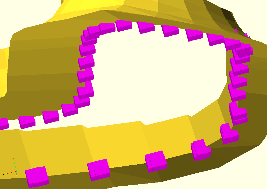

I have checked the jagged lines. It may be due to angle between the 2 prisms at this location. when you replace "z210" with "z180" in line number 8, these jagged lines go away. when you make it "z250", this becomes worse. May be it is related to finding the intersection points correcly On Sat, 22 Jan 2022 at 22:41, Adrian Mariano <avm4@cornell.edu> wrote: > I was looking more closely at the fillet between the U-bar and sphere, > and it appears that there is a funny irregularity. I'm not sure what > is going on, but it looks like there is a jagged top edge and some > non-smooth areas on the fillet. Perhaps the faces are being defined > incorrectly with an off-by-one error? (Maybe this explains so many > warnings.) I attach a picture showing the fillet by itself below. > > Can you make a connection between two arbitrary prisms? (Seems like > the base prism would need to be convex.) I'm intrigued by this. It > may inspire me to write something of my own. In principle a parallel > connection is OK---the fillet is a trivial straight line segment. > It's when you have *no* connection that you're really in trouble. > > On Sat, Jan 22, 2022 at 11:58 AM Sanjeev Prabhakar > <sprabhakar2006@gmail.com> wrote: > > > > Thank you so much for your kind suggestions. > > I will try and improve on code readability and also the warning thing > > > > Limitation of the function "ipf (intersection point for fillets)" is > when the intersection angle is near parallel between the 2 intersecting > solids, it doesn't work. > > Logic used: > > First identify the intersection point between the 2 solids (first one is > the solid which is intersected with and the 2nd one intersecting the first > one). > > from these points trace the points and create the fillets. > > I have tried in few cases and most of the cases it worked, where the > intersection lines are making an angle which is greater than 20 deg, best > would be 90 deg. > > > >
Sun, Jan 23, 2022 1:23 AM
you can see the difference between intersection points at various angles
with following line
color("magenta")points(ip(prism1,prism),.5);
"ip" is the function that captures the intersection points between the 2
prisms.
"ip" is the function that captures the intersection points between the 2 prisms.
On Sun, 23 Jan 2022 at 06:06, Sanjeev Prabhakar sprabhakar2006@gmail.com wrote:

I was studying the fillet and noticed that it has some places where it
pulls away from the mating shape.  Yet somehow it renders.  I don't
understand how this renders, unless the fillet is an entire
self-contained polyhedron?  But it certainly seems undesirable to have
that gap.
