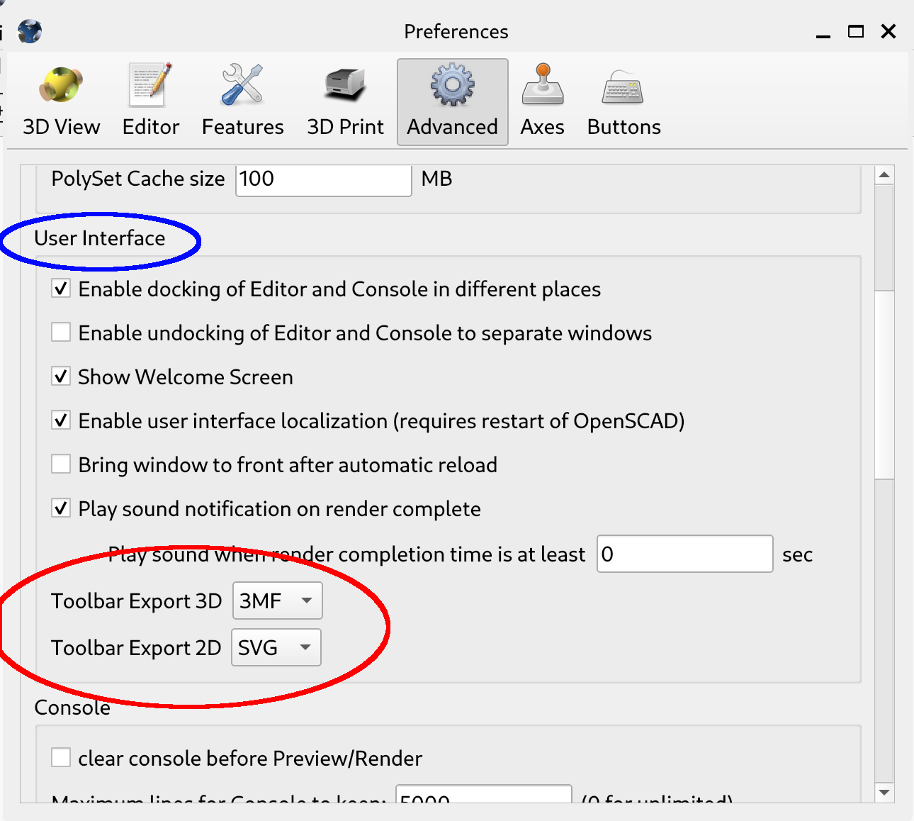

On 07.03.23 14:32, gene heskett wrote:
How do I go about that?  Thanks.
See screenshot...
On 07.03.23 14:32, gene heskett wrote: > How do I go about that?  Thanks. See screenshot... ciao, Torsten.
See screenshot...
Tickity-boo, I was looking in wrong pulldown, thanks a bunch!
