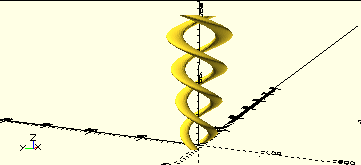

Fri, May 27, 2022 1:44 AM
You can make related shapes with linear_extrude, but it's hard to get
right.
for (a = [0,180]) {
rotate(a)
linear_extrude(height=200, scale=2, twist=720, slices=100) {
translate([20,0]) circle(r=7);
One challenge is that you only get one "scale" argument, and so if you
want the radius of the snake body to increase, the radius of the helix
has to increase too.
Another is that it's remarkably difficult to get linear_extrude to
extrude a twisted cylinder.  The problem is that linear extrude extrudes
from a horizontal cross-section, and the horizontal cross-section of a
twisted cylinder is not a circle - it's more of a crescent.  (But that's
not right either.)  I derived the correct shape once, but I don't
remember how.  It might well have been using some horrible mechanism
like taking a cross-section of a sweep.  And, of course, that's before
you try to get the diameter of the cylinder to change.
Net, I think your first bet is to use a sweep function.  Beyond that,
especially if you want to add texture, I think you're in DIY polyhedron
territory.  Adding texture would be... interesting... especially if you
don't want the texture to scale with the size of the triangle.

It occurred to me that if the original interest is in making a snake
spiral then really the linear extrude approach doesn't work at all,
because it produces a progressively flatter shape.  You need to use an
elliptical cross section, which changes as the curvature of the helix
changes---based on the sine of the angle, I suppose.  The only easy
way to get this right is with a path sweep operation that keeps the
snake body perpendicular to the path, e.g.:
function schlrad(d,l,y)=d/l*(y+l/2/d);
module schlange(l=20,d=2,resolution = 12, turns=3)
steps = 75;
path_sweep(circle(r=1,$fn=resolution), path =
[for(y=lerpn(0,l,steps))
zrot(turns*360 * y/l, [schlrad(d=d,l=l,y=y),0,y])]);
schlange();
All is not lost for adding scales, though.  You can still convert this
approach to use skin() by using the transforms option to path_sweep().
I've written this below so the polygon list is constructed based on a
numerical index could be used for the scale pattern.
steps = 75;
T = path_sweep(path = [for(y=lerpn(0,l,steps))
zrot(turns*360 * y/l, [schlrad(d=d,l=l,y=y),0,y])],
transforms=true);
polygons = [for(i=idx(T)) apply(T[i],path3d(circle(r=1,$fn=resolution)))];
skin(polygons,slices=0);
schlange();

Fri, May 27, 2022 2:53 PM
module snake(){
   for(j=[80:200]){
       rotate([0,0,j10])
       translate([j
0.1,j0.1,j3])
       sphere(d=(j*0.05));
  snake();
 rotate([0,0,180])snake();
 cylinder(h=650,d=12);
Fn6 takes a while ;)

BB
Bruno Boettcher
Fri, May 27, 2022 3:53 PM
Thanks Adriano,
that ones nice, i can base myself on that one!
