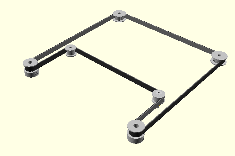

I wrote my own rounded polygon code initially in response to a question on
this list and I now use it to model belt paths and calculate their length.
It is only about 65 lines of code.

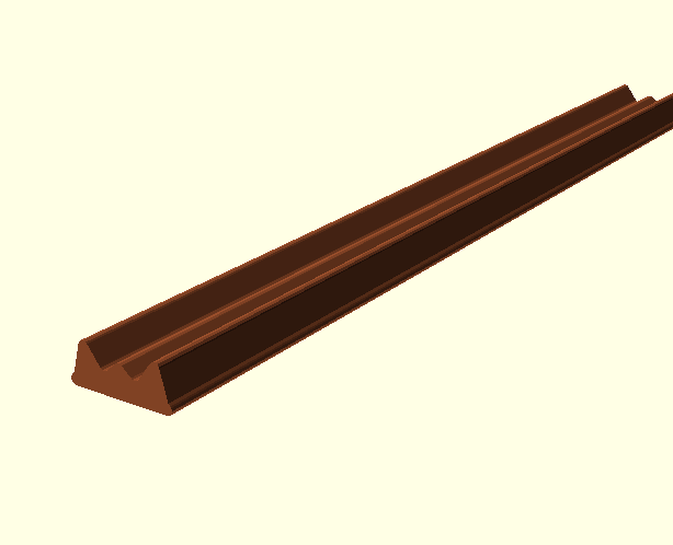

I also modelled a rubber sealing with complex profile strip with it.

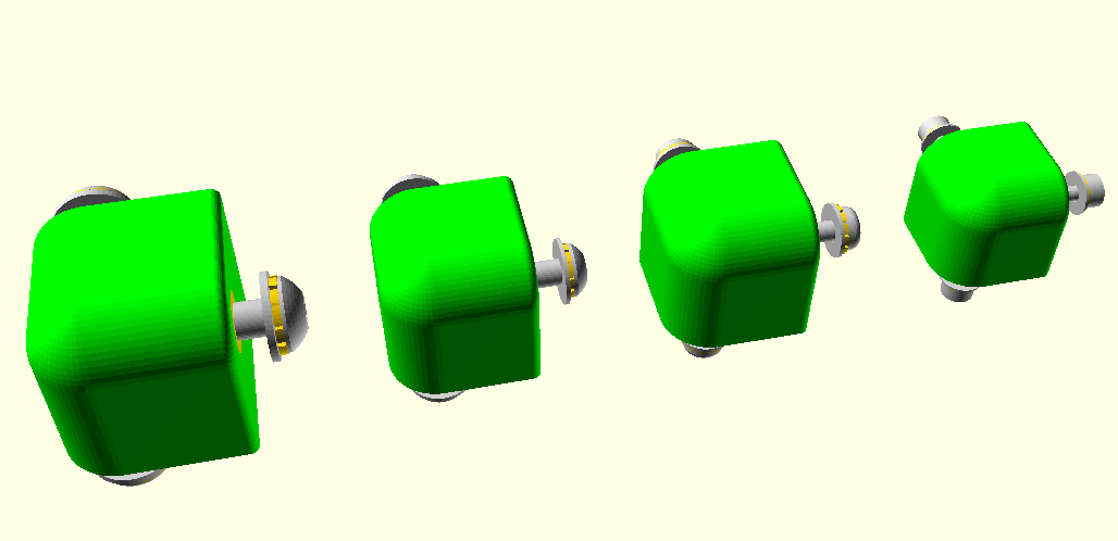

For 3D rounded thing I use hull.
module corner_block(screw = def_screw, name = false) {
stl(name ? name : str("corner_block", "_M", screw_radius(screw) * 20));
r = 1;
cb_width = corner_block_width(screw);
cb_height = cb_width;
cb_depth = cb_width;
insert = screw_insert(screw);
corner_rad = insert_outer_d(insert) / 2 + wall;
offset = corner_block_hole_offset(screw);
    hull()  {
        translate([r, r])
            rounded_cylinder(r = r, h = cb_height, r2 = r);
        translate([r, cb_depth - r])
            cylinder(r = r, h = cb_height - corner_rad);
        translate([cb_width - r, r])
        translate([offset, offset, offset])
            sphere(corner_rad);
        translate([offset, offset])
            cylinder(r = corner_rad, h = offset);
        translate([offset, r, offset])
            rotate([-90, 0, 180])
                rounded_cylinder(r = corner_rad, h = r, r2 = r);
        translate([r, offset, offset])
            rotate([0, 90, 180])
        corner_block_v_holes(screw)
            insert_hole(insert, overshoot);
        corner_block_h_holes(screw)
            insert_hole(insert, overshoot, true);

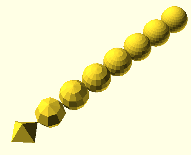

After you pointed out the bug in sphere I wrote my own that rotate extrudes
a semicircle ensuring the number of vertices is a multiple of 4, so the
poles and equator always have vertices on the axes.
// Replicate OpenSCAD logic to calculate number of sides from radius
function r2sides(r) = $fn ? $fn : ceil(max(min(360/ $fa, r * 2 * PI / $fs),
5));
// Round up number of sides to multiple of 4 to ensure points on all axes
function r2sides4n(r) = floor((r2sides(r) + 3) / 4) * 4;
// Circle with multiple of 4 vertices
module Circle(r, d = undef) {
R = is_undef(d) ? r : d / 2;
circle(R, $fn = r2sides4n(R));
// Semi circle
module semi_circle(r)
render() intersection() {
Circle(r);
    sq = r + 1;
    translate([-sq, 0])
        square([2 * sq, sq]);
// Sphere that has vertices on all three axes. Has the advantage of giving
correct dimensions when hulled
module sphere(r = 1, d = undef) {
rotate_extrude($fn = r2sides4n(R))
rotate(-90)
semi_circle(R);
Yes I literally reinvented the wheel by defining my own version of circle!

implement correctly in OpenSCAD.  (I printed about 15 hours of stuff
that
all failed before I realized that spheres in OpenSCAD are undersized.)

Not sure what the 400 lines of code does that mine doesn't. I just take a
list of 3 vectors that are X,Y coordinates and a radius that can be
positive, negative or zero. I then just construct the tangents between the
circles. Here is the code:
function circle_tangent(p1, p2) =
let(
r1 = p1[2],
r2 = p2[2],
dx = p2.x - p1.x,
dy = p2.y - p1.y,
d = sqrt(dx * dx + dy * dy),
theta = atan2(dy, dx) + acos((r1 - r2) / d),
xa = p1.x +(cos(theta) * r1),
ya = p1.y +(sin(theta) * r1),
xb = p2.x +(cos(theta) * r2),
yb = p2.y +(sin(theta) * r2)
)[ [xa, ya], [xb, yb] ];
function rounded_polygon_tangents(points) =
let(len = len(points))
[for(i = [0 : len - 1])
let(ends = circle_tangent(points[i], points[(i + 1) % len]))
for(end = [0, 1])
ends[end]];
function sumv(v, i = 0, sum = 0) = i == len(v) ? sum : sumv(v, i + 1, sum +
v[i]);
// cross product of 2D vectors is the area of the parallelogram between
them. we use the sign of this to decide if the angle is bigger than 180.
function rounded_polygon_length(points, tangents) =
let(
len = len(points),
indices = [0 : len - 1],
straights = [for(i = indices) norm(tangents[2 * i] - tangents[2 * i +
1])],
arcs = [for(i = indices) let(p1 = tangents[2 * i + 1],
p2 = tangents[(2 * i + 2) % (2 * len)],
corner = points[(i + 1) % len],
c = [corner.x, corner.y],
v1 = p1 - c,
v2 = p2 - c,
r = abs(corner.z),
a = acos((v1 * v2) / sqr(r))) PI *
(cross(v1,v2) <= 0 ? a : 360 - a) * r / 180]
sumv(concat(straights, arcs));
module rounded_polygon(points, _tangents = undef) {
len = len(points);
indices = [0 : len - 1];
tangents = _tangents ? _tangents : rounded_polygon_tangents(points);
difference(convexity = points) {
        for(i = indices)
            if(points[i][2] > 0)
                hull() {
                    translate([points[i].x, points[i].y])
                        circle(points[i][2]);
                    polygon([tangents[(2 * i - 1 + 2 * len) % (2 *
len)], tangents[2 * i], [points[i].x, points[i].y]]);
        polygon(tangents, convexity = points);
    for(i = indices)
        if(points[i][2] < 0)
            hull() {
                    circle(-points[i][2]);
                polygon([tangents[(2 * i - 1 + 2 * len) % (2 *len)],
This illustrates why I don't use somebody else's 400 line library when I

Yes my code doesn't round a polygon with sharp vertices, instead it takes a
list of circles and joins them tangentially to make a rounded polygon, so
the input for a given shape is different. I.e. I start with centre points
and radii of the actual shape rather than a list of imaginary vertices that
get rounded off. It does cope with concave shapes. The belt path example I
showed is concave. I use negative radii to specify the concave corners, and
zero for a sharp corner. I think it can make exactly the same set of shapes
but the input data is different.
