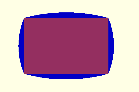

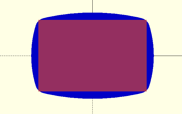

To get a rectangle with rounded edges, intersect circles:
$fn = 120;
module arc_square(sx,sy,Rx,Ry) render()
intersection(){
translate([-Rx+sx/2,0]) circle(Rx);
translate([ Rx-sx/2,0]) circle(Rx);
translate([0,-Ry+sy/2]) circle(Ry);
translate([0, Ry-sy/2]) circle(Ry);
To round vertices, use offset:
offset(r) square([a,b], center=true);
To get both, a little math is needed:
a = 30; // rectangle width
b = 20; // rectangle height
e = 2;  // rect. side bulge
Rx = e/2 + bb/e/8;
Ry = e/2 + a
a/e/8; echo(Rx, Ry);
r = 3;
color("blue")
offset(r)
arc_square(a+2e-2r,b+2e-2r,Rx,Ry);
translate([0,0,2]) square([a,b],center=true); // just to compare
Using Pythagoras
R^2 = (R-e)^2 + (a/2)^2
0 = -2eR + e^2 + (a/2)^2
R = e/2 + (a/2)^2 / e / 2
Now just linear_extrude() this polygon.

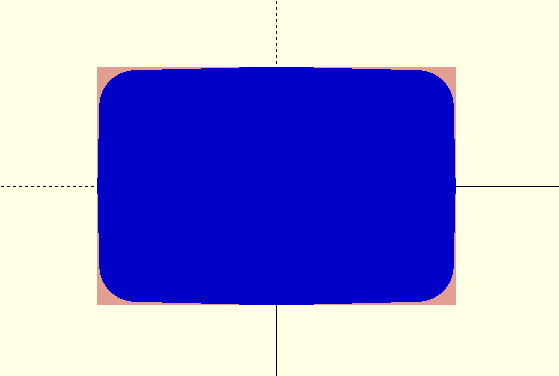

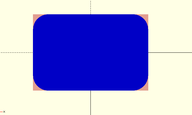

Ronaldo, Why does your offset square example above have slightly curved edges? It should have straight edges and rounded corners and does when I try it. On 6 April 2017 at 05:22, Ronaldo Persiano <rcmpersiano@gmail.com> wrote: > 2017-04-06 0:33 GMT-03:00 MichaelAtOz <oz.at.michael@gmail.com>: > >> > one side slightly convex >> >> > using that crufty OpenSCAD version 2012.05.26 >> >> Thus no offset() >> > > Does it have minkowski() ? > > module offset(r) { > very_big = 1e16; // something greater then the children size > render() > if(r>0) > minkowski(){ > children(); > circle(r); > } > else > difference(){ > square(very_big-1,center=true); > minkowski(){ > difference(){ > square(very_big,center=true); > children(); > } > circle(-r); > } > } > } > > > > _______________________________________________ > OpenSCAD mailing list > Discuss@lists.openscad.org > http://lists.openscad.org/mailman/listinfo/discuss_lists.openscad.org > >
Thu, Apr 6, 2017 6:29 PM
2017-04-06 7:24 GMT-03:00 nop head nop.head@gmail.com:
Ronaldo,
You are right. The second image is a wrong image. That is what I should
have include instead:
I should correct myself in the statement that hull() would not help here.
It is possible to do it just with hull, without offset() or minkowski().
But the the math would be a little more complicate and I mention it here
for completeness. The solution would be the intersection of the rounded
edge rectangle with 4 big triangles with rounded vertices (a hull of 3
circles) well dimensioned and positioned.
