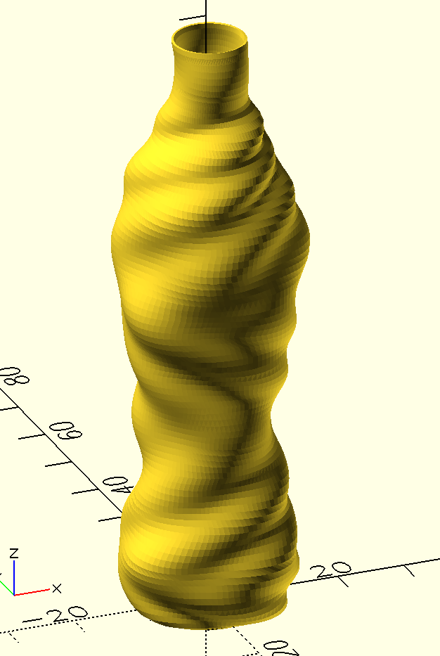

bottle with wrapped sinewave surface
Fri, Dec 12, 2025 3:10 PM
An interesting bottle after wrapping a sinewave surface around a plain
bottle.
scad file with points list can be downloaded from here:
https://github.com/sprabhakar2006/openSCAD/blob/main/bottle_with_sinewaves_wrapping.scad
[image: Screenshot 2025-12-12 at 8.25.27 PM.png]
python code is here:
from openscad4 import *
p1=cr2dt([[-3,0],[3,0,2],[3,7,10],[-5,20,40],[7,30,40],[-10,20,7],[0,10]],20)
p1=equidistant_path(p1,99)
c1=circle(10,s=200)
h1=[ 2pi(10+x-.3) for (x,y) in p1 ]
l1=l_(a_(p1)[:,1])
c2=cpo([l1,h1])
w1=rot('x90',sinewave(100,5,2,100))
w2=rot('x90z90',sinewave(100,5,2,100))
s1=surface_from_2_waves(w1,w2,1)
s2=[[s1[i][j] for j in range(len(s1[0])) if l_lenv_o(s1[i][:j])<h1[i]]for i
in range(len(s1)) ]
sol=rot('y90',prism(c1,p1))
sol1=[ bspline_closed(wrap_around(s2[i],sol[i]),3,100) for i in
range(len(sol))]
sol1=[ translate(a_(sol[i][0])-a_(sol1[i][0]),sol1[i]) for i in
range(len(sol1))]
sol2=surface_offset(sol1,-.5)
sol3=rot('y-90',sol1+flip(sol2))
sol4=cpo([ bspline_open(p,3,200) for p in cpo(sol3) ])
fo(f'''
difference(){{
{swp(flip(sol4))}
//{swp(cut_plane([0,-1,0],[200,200],50))}
python libraries to install
numpy, scipy, sympy, scikit-image
openscad4 from my github page above

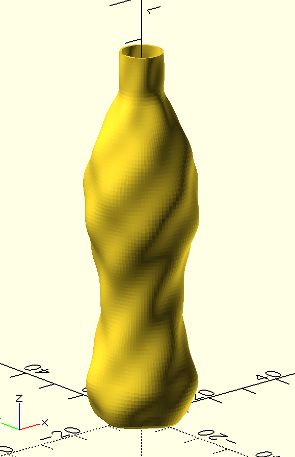

Mon, Dec 15, 2025 4:50 PM
I made a mistake in the last code, this one is the correct one:
[image: Screenshot 2025-12-15 at 10.16.26 PM.png]
python code:
c1=circle(10,s=200)
h1=[ 2pi(10+x) for (x,y) in p1 ]
l1=l_(a_(p1)[:,1])
c2=cpo([l1,h1])
c3=c32(xzc(c23(c2)))
l1=translate([.1,0,0],c23(cpo([c3,c2])))
s1=rot('z.0001',surface_from_2_waves(w1,w2,1))
s2=[ fit_pline2line(s1[i],l1[i]) for i in range(len(s1)) ]
s3=rot('y90', prism(offset(c1,.01),p1))
s4=[translate(-a_(s2[i][0]), wrap_around(s2[i],s3[i]+[s3[i][0]])) for i in
range(len(s3)) ]
s5=surface_offset(s4,0.5)
bottle=rot('y-90',s4+flip(s5))
fo(f'''
difference(){{
{swp(bottle)}
