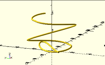

I got path_extrude from:
https://www.thingiverse.com/thing:186660
and then... If you need a spring but think just a circular spring is
boring... (Excercise for the reader: Get this to produce a normal
spring).
use <path_extrude.scad>;
np = 11;
n = 4;
m = 3;
x = 20;
y = 20;
r = .8;
for (o=[0:1/np:.9999]) {
myPoints = [ for(t = [0:9:359]) [rcos(t+45),rsin(t+45)] ];
myPath = [ for(t = [-.3:.0025:.54])
[xsin((t+o)360n),ysin(((t+o)+.25)360m),t<.05?4:(t<.45?t*80:36)]];
path_extrude(exShape=myPoints, exPath=myPath);
I was just going to showcase this "for fun" hoping you'd appreciate
it, but I tried generating an STL and it failed. So this has become
a bugreport of sorts as well....
On the nightly I get this preceding the following messages:
WARNING: [fast-csg] Corefinement corefinement mesh union failed with
an error: Unauthorized intersections of constraints
on the release version I only get something like this:
ERROR: CGAL error in CGALUtils::applyUnion3DHybrid: CGAL ERROR: assertion violation!
Expr: itl != it->second.end()
File: /usr/include/CGAL/Nef_3/SNC_external_structure.h
Line: 1144

If you get a CGAL error, the program is building bad geometry.
Don't just assume you can paint any bunch of points to make something valid.
If you try bad geometry with the dev feature fast-csg, don't expect it to work any better.
p.s. Please add a Subject next time.

It seems that at least some of your paths have self-intersections.

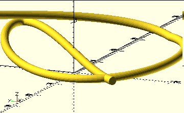

I don't really know much about self-intersection cases, but I noticed
that your figure has four "strands", so I modified it to emit only one,
the o=0 strand.
Its self-intersection is not subtle; it loops around in XY before Z gets
off its baseline.

Ah! Ok! Yeah, so because the "extrude" operation creates a single
object from a bunch of points and that needs to be a "proper" object,
I can't just expect it to normally union the parts. Hmm. Ok.
I intended to "loop around in XY" to be just over 1/np across the
loop. Thus with all the strands, it would complete the loop. But after
adjusting start and end-<t> it looked ok on the screen, so I didn't
bother checking if I got "just enough" or "way more than i
wanted. You've seen that it does "way more than I wanted". I'll fix it
and see if it helps. :-)
