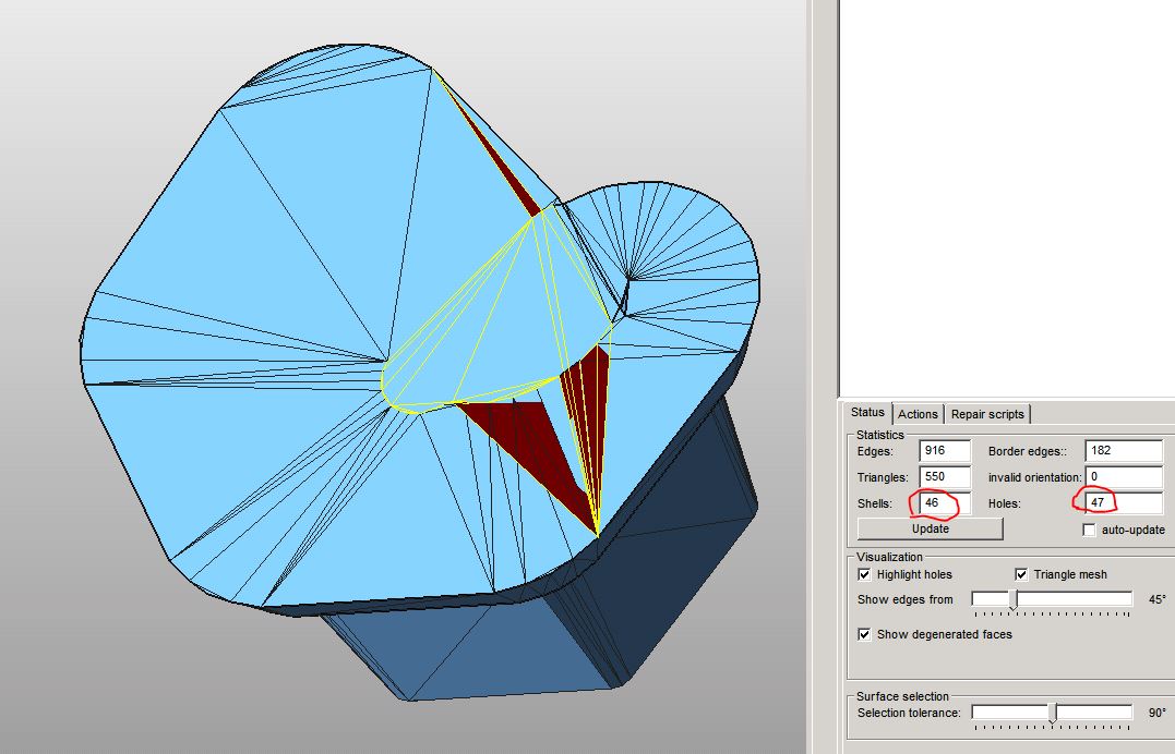

In case others try this, just comment out the "use <shakespeare..."
line.
Try
translate([0,-10,0]) // so they don't touch
#extrude_open(path1);
//#extrude_open(path2);
cube(1);
re assertion violations, just have a 'cube(1);' with your object will force
CGAL union.
Preview the above it points to some triangulation visual artefacts, on the
bottom, that may be a clue.
Looks likely there are holes.
Without the cube, path1 can be rendered and exported.
The STL shows this:

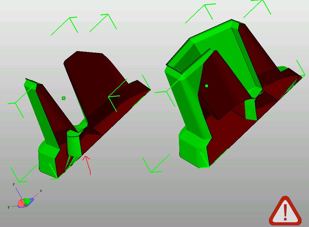

This is it, the STL, cut in half.
You can see that internal geometry, almost certainly makes self-intersections.
Also not the green triangles to the left of the arrow, green means 'outside' face.

Now, on to the main point.  In your example, you construct a shape which is
a sort of C shape and then you run rounded_sweep() on it.  The profile you
give to rounded sweep expands your input shape enough that the two ends of
the shape intersect.  This is not allowed!  No self intersection!  I'm
going to try to include an image showing what happens.
Instead of looking at the 3d shape I'm plotting the sequence of offsets that
will give rise to the shape.  When the curve contacts the other arm of the
curve, crazy stuff happens in offset().  But even if it didn't, you'd still
get an invalid polyhedron.  Is your goal to have everything blend together
into a top layer with random holes in it in places?  It seems sort of odd.
But if you want a top like that you're going to have to add it separately.
You might, for example, take the convex hull of your 2d profile for your
entire cutter, expand it a bit with offset(), extrude it to the desired
thickness and union that onto your cutter.
In the picture I'm going to try to attach, I've shown your base profile in
yellow, then the subsequent profiles in red, green and purple.  I omitted
the last profile because things have already failed at profile #3.  For this
example I turned check_valid off because the result is comprehensible.  With
check valid on, you get wild and crazy results that it's hard to make sense
of.  The function version of offset() that I wrote is not smart enough to do
something intelligent with this kind of situation (which would require
returning multiple separate paths for various internal holes that arise).
Also the polyhedron faceting code wouldn't know what to do with multiple
separate paths.  It's your responsibility to avoid these self-intersection
situations.
