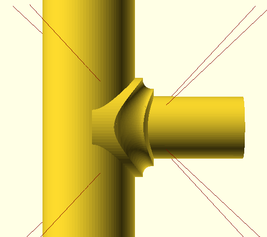

Wed, Jan 15, 2025 10:50 PM
0.001 produces not fillet; 0.01 produces this monstrosity:
[cid:part1.e0GaT98g.bf3bCNJn@jonbondy.com]

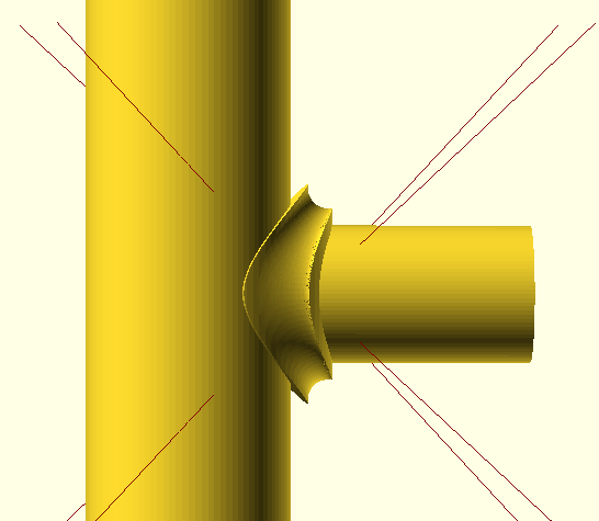

Wed, Jan 15, 2025 10:54 PM
$fn is set to 100 in your code.
I see the vertical and horizontal tubes, but no fillet.
I am running under Windows.
d = d-5 produces this

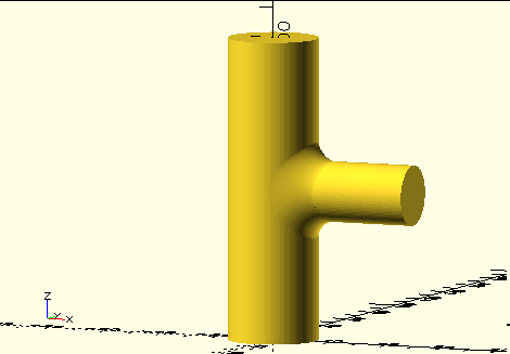

Thu, Jan 16, 2025 12:42 AM
Taking the original and replacing the 0.0001 with 0.01 (and cleaning up
the indentation):
module tube(d){
    linear_extrude(100)
            circle(d=d);
            circle (d=d-0.01);

yields (Windows 11, OpenSCAD 2024.12.26, preview or Manifold:
And the same for preview in 2021.01, though it takes a very long time there.

Thu, Jan 16, 2025 1:44 AM
Works perfectly!  Thank you!

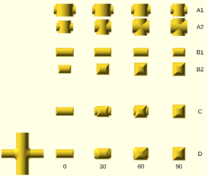

I wasn't really sure how this worked, so I deconstructed it and made
sort of an exploded diagram showing the components of the result.
One thing that makes it a bit hard to follow is the fact that it works
with tubes rather than cylinders.  Some of the shapes being manipulated
are very very small and rely on hull to turn them back into full
shapes.  I switched it over to cylinders and that made it easier to see.
I also changed it over to being a cross-shaped intersection, because
making everything be centered got rid of some translates that were
confusing me, and made some aspects of the diagram below easier.
Here's the diagram.  Each column (0, 30, 60, 90) is one component of the
final curve; each row (A, B, C, D) is a step in the process.  This is a
very low-resolution version so that you have more of a chance of seeing
how the results fit into the final product; the original model had many
more columns so as to produce a smoother curve.
Row A1 is the combination of a horizontal cylinder with the diameter of
the object's horizontal cylinder, and a vertical cylinder that varies in
diameter from the total length of the bevel down to the diameter of the
object's original vertical cylinder.
Row A2 is sort of the transposition of A1; the vertical cylinder is the
diameter of the object's vertical cylinder, and the horizontal cylinder
grows in diameter from the diameter of the horizontal cylinder to the
total vertical length of the bevel.
Row B1 is the intersection of the two shapes in row A1, so it is a
segment of horizontal cylinder that varies in length from the total
horizontal length of the bevel down to the diameter of the vertical
cylinder.
Row B2 is similarly the intersection of the two shapes in row A2.
Row C is the union of the shapes in B1 and B2.
Row D is the hull of the shape in C.
Finally, the shapes in row D are unioned to produce the final shape to
the left.
It's a clever technique.

One thing I would like to add here is that increase of diameters is not in
straight line but in kind of circular traces like cos theta and sin theta
for the 2 solids i.e. vertical and horizontal cylinders.
For example if vertical cylinder is increased in dia by sin 30, horizontal
cylinder is increased by cos 30.
At 0 deg 1 cylinder is increased by 1 unit while the other is at its
original shape.
This will give the desired shape of the fillet
very low-resolution version so that you have more of a chance of seeing how
the results fit into the final product; the original model had many more
grows in diameter from the diameter of the horizontal cylinder to the total
Row B1 is the intersection of the two shapes in row A1, so it is a segment
of horizontal cylinder that varies in length from the total horizontal
length of the bevel down to the diameter of the vertical cylinder.
Finally, the shapes in row D are unioned to produce the final shape to the
left.
 made sort of an exploded diagram showing the components of the result.
 works with tubes rather than cylinders.  Some of the shapes being
 manipulated are very very small and rely on hull to turn them back
 into full shapes.  I switched it over to cylinders and that made
 it easier to see.
 because making everything be centered got rid of some translates
 that were confusing me, and made some aspects of the diagram below
 easier.
 of the final curve; each row (A, B, C, D) is a step in the
 process.  This is a very low-resolution version so that you have
 more of a chance of seeing how the results fit into the final
 product; the original model had many more columns so as to produce
 a smoother curve.
 diameter of the object's horizontal cylinder, and a vertical
 cylinder that varies in diameter from the total length of the
 bevel down to the diameter of the object's original vertical cylinder.
 is the diameter of the object's vertical cylinder, and the
 horizontal cylinder grows in diameter from the diameter of the
 horizontal cylinder to the total vertical length of the bevel.
 total horizontal length of the bevel down to the diameter of the
 vertical cylinder.
 shape to the left.

try this - gives a flange.
 up=40; //diameter of upright rod
 hor=20; // diameter of horizontal rod
 hup =100; //height of upright
 lhor = 50; //length of horizontal (from centre)
 bevel=15;
fl=3; //flange width
 module rod(d){
       linear_extrude(100)
            circle(d=d);
 module fillet(a,b,c,d){
   hull(){
     intersection(){
         rod(up+a);  //upright tube
       translate([-0,0,50])
       rotate([0,90,0])
         rod(hor+b);
          intersection(){
         rod(up+c);  // side tube
       rotate([0,90,0])
         rod(hor+d);
 $fn=100;
        cylinder(d=up,h=hup);
       rotate([0,90,0])
       cylinder(d=hor,h=lhor);
     for (j= [0:2:90]){
       a=bevelsin(j);
         b=bevel
cos(j);
          fillet(fl2,a,b,fl2);
to do -
make tubes of given wall thickness
angle joint
make tube joints smooth on inside. (difference a smaller fillet, possibly )
try this - gives a flange.  up=40; //diameter of upright rod  hor=20; // diameter of horizontal rod  hup =100; //height of upright  lhor = 50; //length of horizontal (from centre)  bevel=15; fl=3; //flange width  module rod(d){        linear_extrude(100)             circle(d=d);  }  module fillet(a,b,c,d){    hull(){      intersection(){          rod(up+a);  //upright tube        translate([-0,0,50])        rotate([0,90,0])          rod(hor+b);          }           intersection(){          rod(up+c);  // side tube        translate([-0,0,50])        rotate([0,90,0])          rod(hor+d);          }  }  }  $fn=100;         cylinder(d=up,h=hup);        translate([-0,0,50])        rotate([0,90,0])        cylinder(d=hor,h=lhor);      for (j= [0:2:90]){        a=bevel*sin(j);          b=bevel*cos(j);           fillet(fl*2,a,b,fl*2);      }  /* to do - make tubes of given wall thickness angle joint make tube joints smooth on inside. (difference a smaller fillet, possibly ) */
