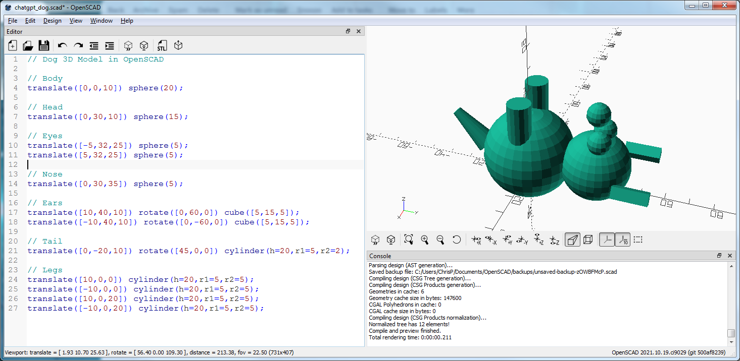

This is the best result of asking it to design a 3D model of a dog.
It is amazing it has a mental model of an abstract dog. It is supposed to
be a large language model so it should know what features a dog has in
words but to know their geometric shapes and relationships in 3D and also
to know OpenSCAD syntax and semantics is amazing considering it says it
can't run the code itself or see pictures created by me.

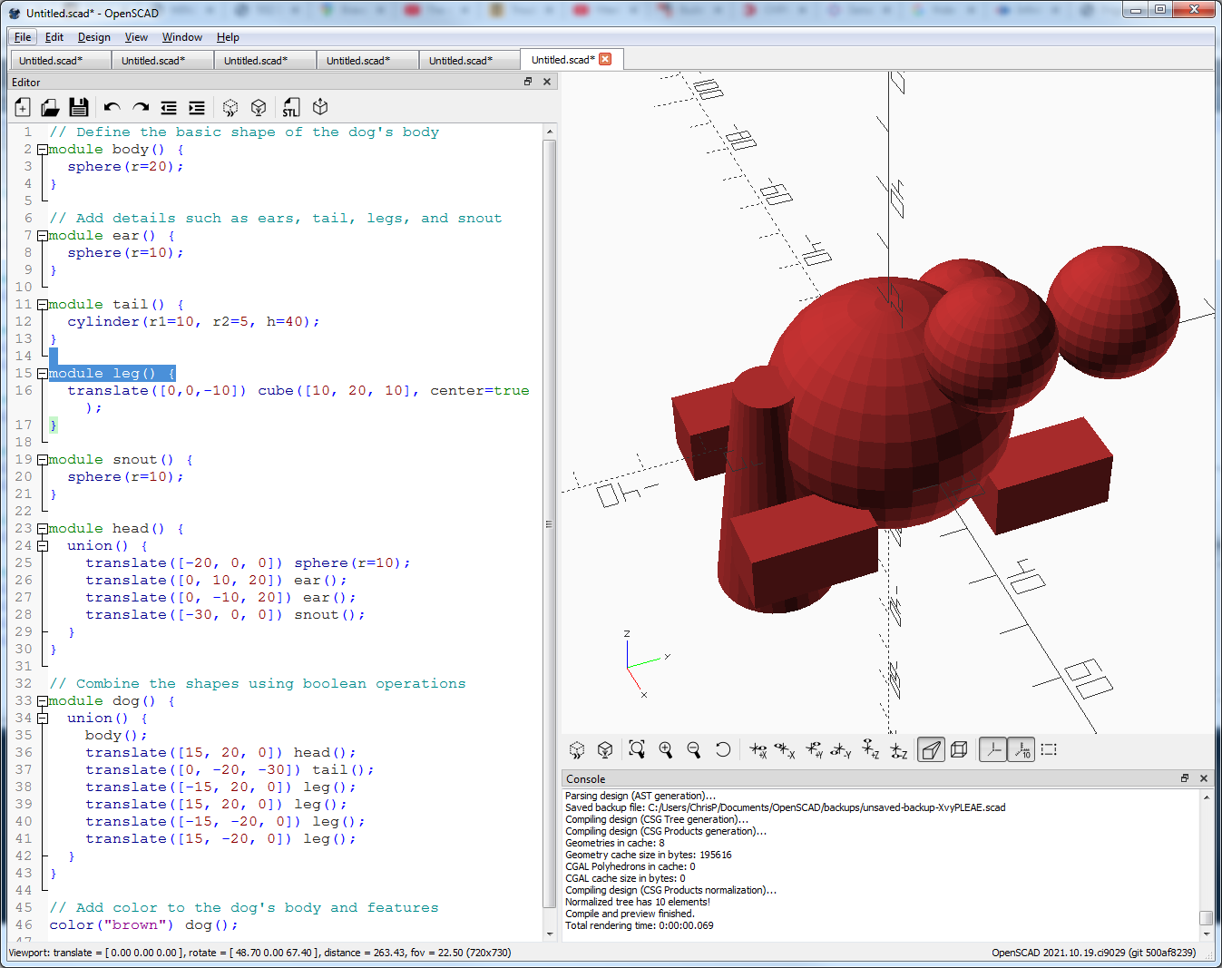

Disappointingly, it always seems to fail at creating four legs at the four
corners. In this version they are stacked vertically above each other so
two are inside the body. Not sure why it is upside down. I didn't specify
it was alive!
This is another attempt, somewhat worse. On this day, no matter how many
times I tried to correct it could never get everything in the right place
but it did make it brown.

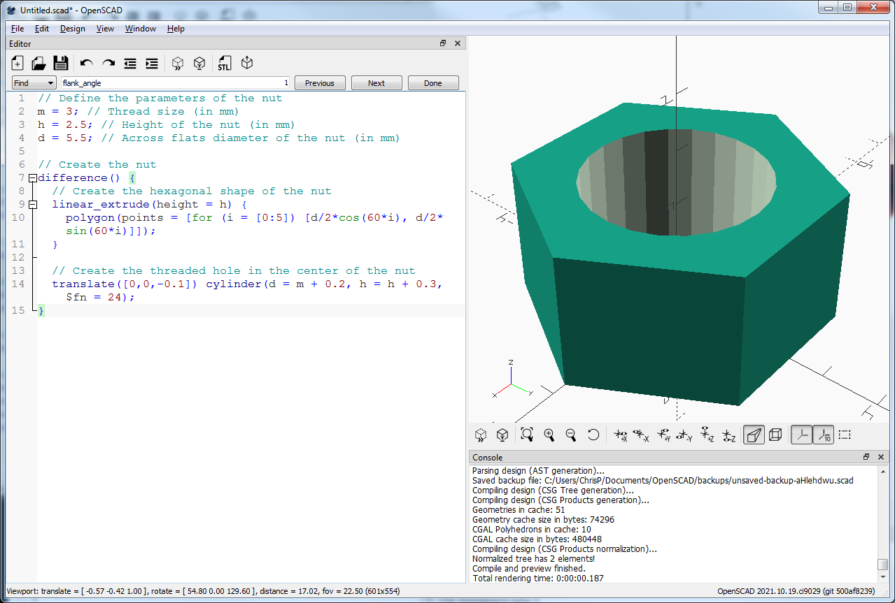

I also asked it to make a 3D model of an M3 nut. After many iterations it
made this.
It is not quite the right size. Some iterations had the correct hexagon
size but had z fighting or just a pocket in the bottom. It was a struggle
to get the subtracted cylinder correct.
I also suggested it could do the difference in 2D and extrude that but it
could never get the right. In some of those attempts it started using code
that was not correct OpenSCAD code. E.g.

On 06/04/2023 12:27, nop head wrote:
I have been playing with ChatGPT and OpenSCAD and find it both
amazing that it has a go and disappointing it can't get anything
completely correct.
supposed to be a large language model so it should know what
features a dog has in words but to know their geometric shapes and
relationships in 3D and also to know OpenSCAD syntax and
semantics is amazing considering it says it can't run the code
the four corners. In this version they are stacked vertically above
each other so two are inside the body. Not sure why it is upside
down. I didn't specify it was alive!
many times I tried to correct it could never get everything in the
right place but it did make it brown.
iterations it made this.
hexagon size but had z fighting or just a pocket in the bottom. It
was a struggle to get the subtracted cylinder correct.
but it could never get the right. In some of those attempts it
started using code that was not correct OpenSCAD code. E.g.
// Define variables
 d = 10; // Across flats diameter
 h = 5; // Nut height
 // Calculate corner-to-corner diameter of hexagon
 c = d / cos(30);
 // Define points for hexagon
 points = [    [d/2, 0],
     [c/2, d/2],
     [-c/2, d/2],
     [-d/2, 0],
     [-c/2, -d/2],
     [c/2, -d/2]
 // Define circle for hole
 hole_d = d * 0.7; // Diameter of hole
 hole_r = hole_d / 2; // Radius of hole
 hole = circle(r=hole_r);
 // Create nut shape by subtracting circle from hexagon
 nut = polygon(points) - hole;
 // Extrude nut shape to create 3D object
 linear_extrude(height=h) nut;
It starts using modules in expressions and assigning geometry
to variables. Not sure where it sees code like that.
dog.
and
at
above
upside
how
the
It
that
// Define variables
 c = d / cos(30);
     [c/2, d/2],
     [-c/2, d/2],
     [-d/2, 0],
     [-c/2, -d/2],
     [c/2, -d/2]

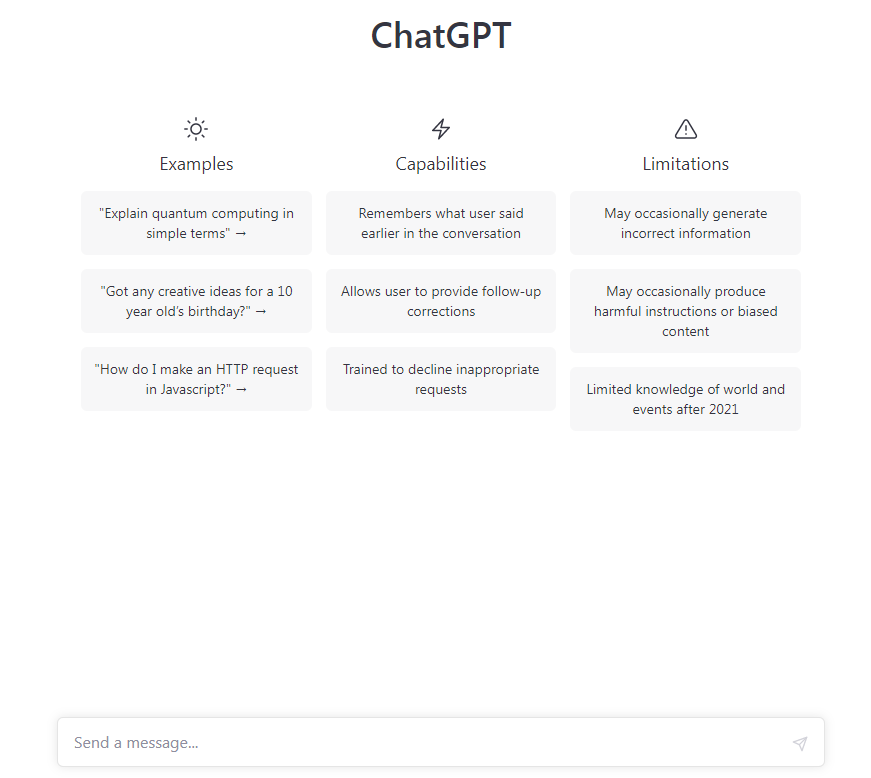

Are you using https://chat.openai.com/chat? That just prompts with "send a
message".
It
that
// Define variables
c = d / cos(30);
[c/2, d/2],
[-c/2, d/2],
[-d/2, 0],
[-c/2, -d/2],
[c/2, -d/2]

Are you using https://chat.openai.com/chat? That just prompts with "send a message". [image: image.png] On Thu, 6 Apr 2023 at 20:49, larry <lar3ry@sasktel.net> wrote: > On Thu, 2023-04-06 at 18:43 +0100, nop head wrote: > > Seems like a different version to what I see. Easy to login and just > > type a question and hit enter. > > I found a place that does just that. On my first attempt, I only had a > place in the upper right to type things into . It was just below the a > bunch of formatting icons, and hitting enter after typing in a question > did nothing at all. > > I closed the tab, and later on, brought it up again. Turns out I was > still logged in, and now, a centre panel shows up with a box at the > bottom that says "Ask or search anything". THAT works. > > > On Thu, 6 Apr 2023 at 18:12, larry <lar3ry@sasktel.net> wrote: > > > On Thu, 2023-04-06 at 13:50 +0100, Raymond West wrote: > > > > These results are similar to what I found. > > > > So, I asked it the question... > > > > raywest@raywest.com > > > > > > > > would you like to write an email, asking the openscad mailing > > > > list > > > > members, if it would be useful for them to derive and submit test > > > > questions about openscad to chatgpt, in the hope that it could be > > > > trained to write correct openscad scripts? If so write the email, > > > > and > > > > I'll post it on your behalf. > > > > > > Someone should ask it how to write a web site that is actually > > > intuitive and usable. > > > > > > 1. "magic code" has to be entered into 6 boxes that are drawn as > > > what > > > look like very thin, very light blue boxes on a white screen. > > > > > > 2. Each time I tried to log in with the 'magic', it sent me a new > > > code, > > > which I did not realize for two reasons. (a) my email is fetched > > > every > > > 5 minutes, and (b) there was no other instruction other than a > > > cutesy > > > 'let's try some magic', without specifying that it's part of every > > > login. > > > > > > So I finally got it figured out, and successfully logged into > > > ChatGPT > > > 4. Typed in a question, and found no way to actually have it > > > proceed. > > > > > > Not at all impressed. > > > > > > > Sure, I can draft an email for you. Here's one possible version: > > > > Subject: Seeking OpenSCAD test questions for ChatGPT training > > > > Dear OpenSCAD Mailing List Members, > > > > As a large language model trained on the GPT-3.5 architecture, > > > > I'm > > > > constantly learning and improving my ability to generate text in > > > > a > > > > variety of contexts. Recently, I've been exploring the world of > > > > 3D > > > > modeling with OpenSCAD, and I'm excited about the potential for > > > > me to > > > > be trained to write correct OpenSCAD scripts. > > > > To that end, I'm reaching out to the OpenSCAD community to see if > > > > any > > > > of you would be interested in deriving and submitting test > > > > questions > > > > related to OpenSCAD. These questions could cover a range of > > > > topics, > > > > from basic syntax and concepts to more advanced techniques and > > > > applications. The goal is to provide me with a diverse set of > > > > examples that I can use to improve my understanding of OpenSCAD > > > > and > > > > my ability to generate correct scripts. > > > > If you're interested in contributing to this effort, please feel > > > > free > > > > to reply to this email with your questions. Please keep in mind > > > > that > > > > the questions should be focused on testing my knowledge and > > > > abilities > > > > related to OpenSCAD, and should not be overly complex or > > > > esoteric. > > > > Thank you for considering this request, and I look forward to > > > > hearing > > > > from you soon. > > > > Best regards, > > > > ChatGPT > > > > > > > > (Not sure it is registered...) > > > > > > > > On 06/04/2023 12:27, nop head wrote: > > > > > > > > > > > > > > I have been playing with ChatGPT and OpenSCAD and find it both > > > > > amazing that it has a go and disappointing it can't get > > > > > anything > > > > > completely correct. > > > > > > > > > > This is the best result of asking it to design a 3D model of a > > > > > dog. > > > > > > > > > > image.png > > > > > > > > > > It is amazing it has a mental model of an abstract dog. It is > > > > > supposed to be a large language model so it should know what > > > > > features a dog has in words but to know their geometric shapes > > > > > and > > > > > relationships in 3D and also to know OpenSCAD syntax and > > > > > semantics is amazing considering it says it can't run the code > > > > > itself or see pictures created by me. > > > > > > > > > > Disappointingly, it always seems to fail at creating four legs > > > > > at > > > > > the four corners. In this version they are stacked vertically > > > > > above > > > > > each other so two are inside the body. Not sure why it is > > > > > upside > > > > > down. I didn't specify it was alive! > > > > > > > > > > This is another attempt, somewhat worse. On this day, no matter > > > > > how > > > > > many times I tried to correct it could never get everything in > > > > > the > > > > > right place but it did make it brown. > > > > > > > > > > > > > > > image.png > > > > > > > > > > I also asked it to make a 3D model of an M3 nut. After many > > > > > iterations it made this. > > > > > > > > > > image.png > > > > > > > > > > It is not quite the right size. Some iterations had the correct > > > > > hexagon size but had z fighting or just a pocket in the bottom. > > > > > It > > > > > was a struggle to get the subtracted cylinder correct. > > > > > > > > > > I also suggested it could do the difference in 2D and extrude > > > > > that > > > > > but it could never get the right. In some of those attempts it > > > > > started using code that was not correct OpenSCAD code. E.g. > > > > > > > > > > // Define variables > > > > > d = 10; // Across flats diameter > > > > > h = 5; // Nut height > > > > > > > > > > // Calculate corner-to-corner diameter of hexagon > > > > > c = d / cos(30); > > > > > > > > > > // Define points for hexagon > > > > > points = [ [d/2, 0], > > > > > [c/2, d/2], > > > > > [-c/2, d/2], > > > > > [-d/2, 0], > > > > > [-c/2, -d/2], > > > > > [c/2, -d/2] > > > > > ]; > > > > > > > > > > // Define circle for hole > > > > > hole_d = d * 0.7; // Diameter of hole > > > > > hole_r = hole_d / 2; // Radius of hole > > > > > hole = circle(r=hole_r); > > > > > > > > > > // Create nut shape by subtracting circle from hexagon > > > > > nut = polygon(points) - hole; > > > > > > > > > > // Extrude nut shape to create 3D object > > > > > linear_extrude(height=h) nut; > > > > > > > > > > It starts using modules in expressions and assigning geometry > > > > > to variables. Not sure where it sees code like that. > > > > > > > > > > I look forward to the day it can write useful code for me but > > > > > at > > > > > the moment it is always slightly flawed. It seems to learn > > > > > within > > > > > one chat but doesn't carry any of it forward to the next chat. > > > > > > > > > > Bard seems nowhere near as intelligent and just produced what > > > > > looked like a structure definition of defining the size of a > > > > > dog's > > > > > features. Not even valid OpenSCAD code and no geometry. > > > > > > > > > > On Thu, 6 Apr 2023 at 11:55, jeremy ardley via Discuss > > > > > <discuss@lists.openscad.org> wrote: > > > > > > > > > > > > > > > > > > > > > > > > > > > > > ---------- Forwarded message ---------- > > > > > > From: jeremy ardley <jeremy@ardley.org> > > > > > > To: discuss@lists.openscad.org > > > > > > Cc: > > > > > > Bcc: > > > > > > Date: Thu, 6 Apr 2023 18:54:42 +0800 > > > > > > Subject: [OpenSCAD] Re: chat-gpt > > > > > > > > > > > > On 6/4/23 18:32, Raymond West wrote: > > > > > > > > > > > > > > Hi, > > > > > > > > > > > > > > Has anyone been playing with this wrt openscad script > > > > > > generation? > > > > > > > (https://chat.openai.com/chat). I have seen fairly > > > > > > impressive > > > > > > results > > > > > > > with it generating arduino code and python, I think there > > > > > > are > > > > > > more > > > > > > > examples of those on the web, for it to have 'studied'. I > > > > > > experimented > > > > > > > a few months ago, with openscad, and it looked as if there > > > > > > was > > > > > > a > > > > > > > possibility of it being useful. More recently I have spent > > > > > > some spare? > > > > > > > time trying to train it a bit more, but it is pretty > > > > > > tedious, > > > > > > it seems > > > > > > > to have little short term memory, but then it says > > > > > > something > > > > > > > impressive, if you keep pressing it. > > > > > > > > > > > > > > > > > > > I have some recent experience with ChatGPT4 and ChatGPT3.5. > > > > > > ChatGPT4 is > > > > > > a lot better. > > > > > > > > > > > > With both it is the quality of question and scope that > > > > > > matters. > > > > > > If you > > > > > > ask a precise question with limited scope it will usually > > > > > > produce a > > > > > > workable result. If you ask an open ended question you will > > > > > > get > > > > > > less > > > > > > relevant or accurate results. > > > > > > > > > > > > You can also give it code bodies to identify problems. > > > > > > > > > > > > The best strategy is to iterate through your project logic > > > > > > and > > > > > > get small > > > > > > parts of it coded, then take the results of many questions > > > > > > and > > > > > > merge > > > > > > them into your specific code. > > > > > > > > > > > > You can also usefully describe the overall operation of some > > > > > > code and > > > > > > ask to have it broken up into smaller parts that you can > > > > > > then > > > > > > ask > > > > > > specifics about each. > > > > > > > > > > > > jeremy > > > > > > > > > > > > > > > > > > > > > > > > ---------- Forwarded message ---------- > > > > > > From: jeremy ardley via Discuss <discuss@lists.openscad.org> > > > > > > To: discuss@lists.openscad.org > > > > > > Cc: jeremy ardley <jeremy@ardley.org> > > > > > > Bcc: > > > > > > Date: Thu, 6 Apr 2023 18:54:42 +0800 > > > > > > Subject: [OpenSCAD] Re: chat-gpt > > > > > > _______________________________________________ > > > > > > OpenSCAD mailing list > > > > > > To unsubscribe send an email to > > > > > > discuss-leave@lists.openscad.org > > > > > > > > > > > > > > > > > > > > > _______________________________________________ > > > > > OpenSCAD mailing list > > > > > To unsubscribe send an email to > > > > > discuss-leave@lists.openscad.org > > > > _______________________________________________ > > > > OpenSCAD mailing list > > > > To unsubscribe send an email to discuss-leave@lists.openscad.org > > > _______________________________________________ > > > OpenSCAD mailing list > > > To unsubscribe send an email to discuss-leave@lists.openscad.org > > _______________________________________________ > > OpenSCAD mailing list > > To unsubscribe send an email to discuss-leave@lists.openscad.org > _______________________________________________ > OpenSCAD mailing list > To unsubscribe send an email to discuss-leave@lists.openscad.org >
> > > > dog.
> > > > and
> > > > at
> > > > above
> > > > upside
> > > > how
> > > > the
> > > > It
> > > > that
> > > > // Define variables
> > > > c = d / cos(30);
> > > > [c/2, d/2],
> > > > [-c/2, d/2],
> > > > [-d/2, 0],
> > > > [-c/2, -d/2],
> > > > [c/2, -d/2]
