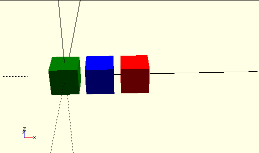

Mon, Apr 7, 2025 12:12 PM
I just had a try and looked at the *.model of the 3mf format of a model
of three cubes in different colors.
what I got is the following output. It defines 4 colors within a
colorgroup, but I can't see how they are related to the three objects.

I just had a try and looked at the *.model of the 3mf format of a model of three cubes in different colors. what I got is the following output. It defines 4 colors within a colorgroup, but I can't see how they are related to the three objects. <?xml version="1.0" encoding="utf-8"?> <model xmlns="http://schemas.microsoft.com/3dmanufacturing/core/2015/02" unit="millimeter" xml:lang="en-US" xmlns:m="http://schemas.microsoft.com/3dmanufacturing/material/2015/02" xmlns:p="http://schemas.microsoft.com/3dmanufacturing/production/2015/06" xmlns:b="http://schemas.microsoft.com/3dmanufacturing/beamlattice/2017/02" xmlns:s="http://schemas.microsoft.com/3dmanufacturing/slice/2015/07">     <resources>         <m:colorgroup id="4">             <m:color color="#FF0000FF" />             <m:color color="#F9D72CFF" />             <m:color color="#0000FFFF" />             <m:color color="#008000FF" />         </m:colorgroup>         <object id="1" name="OpenSCAD Model 1" type="model" p:UUID="fcd1a006-2b9d-4c30-b2db-dfd8fc995bb1" pid="4" pindex="1">             <mesh>                 <vertices>                     <vertex x="16.000000" y="-4.000000" z="-4.000000" />                     <vertex x="16.000000" y="-4.000000" z="4.000000" />                     <vertex x="16.000000" y="4.000000" z="-4.000000" />                     <vertex x="16.000000" y="4.000000" z="4.000000" />                     <vertex x="24.000000" y="-4.000000" z="-4.000000" />                     <vertex x="24.000000" y="-4.000000" z="4.000000" />                     <vertex x="24.000000" y="4.000000" z="-4.000000" />                     <vertex x="24.000000" y="4.000000" z="4.000000" />                 </vertices>                 <triangles>                     <triangle v1="0" v2="1" v3="3" pid="4" p1="0" />                     <triangle v1="0" v2="2" v3="6" pid="4" p1="0" />                     <triangle v1="0" v2="3" v3="2" pid="4" p1="0" />                     <triangle v1="0" v2="4" v3="5" pid="4" p1="0" />                     <triangle v1="0" v2="5" v3="1" pid="4" p1="0" />                     <triangle v1="0" v2="6" v3="4" pid="4" p1="0" />                     <triangle v1="1" v2="5" v3="3" pid="4" p1="0" />                     <triangle v1="2" v2="3" v3="6" pid="4" p1="0" />                     <triangle v1="3" v2="5" v3="7" pid="4" p1="0" />                     <triangle v1="3" v2="7" v3="6" pid="4" p1="0" />                     <triangle v1="4" v2="6" v3="5" pid="4" p1="0" />                     <triangle v1="5" v2="6" v3="7" pid="4" p1="0" />                 </triangles>             </mesh>         </object>         <object id="2" name="OpenSCAD Model 2" type="model" p:UUID="d3b49cb0-3c3f-4d59-a676-31374174cd31" pid="4" pindex="1">             <mesh>                 <vertices>                     <vertex x="6.000000" y="-4.000000" z="-4.000000" />                     <vertex x="6.000000" y="-4.000000" z="4.000000" />                     <vertex x="6.000000" y="4.000000" z="-4.000000" />                     <vertex x="6.000000" y="4.000000" z="4.000000" />                     <vertex x="14.000000" y="-4.000000" z="-4.000000" />                     <vertex x="14.000000" y="-4.000000" z="4.000000" />                     <vertex x="14.000000" y="4.000000" z="-4.000000" />                     <vertex x="14.000000" y="4.000000" z="4.000000" />                 </vertices>                 <triangles>                     <triangle v1="0" v2="1" v3="3" pid="4" p1="2" />                     <triangle v1="0" v2="2" v3="6" pid="4" p1="2" />                     <triangle v1="0" v2="3" v3="2" pid="4" p1="2" />                     <triangle v1="0" v2="4" v3="5" pid="4" p1="2" />                     <triangle v1="0" v2="5" v3="1" pid="4" p1="2" />                     <triangle v1="0" v2="6" v3="4" pid="4" p1="2" />                     <triangle v1="1" v2="5" v3="3" pid="4" p1="2" />                     <triangle v1="2" v2="3" v3="6" pid="4" p1="2" />                     <triangle v1="3" v2="5" v3="7" pid="4" p1="2" />                     <triangle v1="3" v2="7" v3="6" pid="4" p1="2" />                     <triangle v1="4" v2="6" v3="5" pid="4" p1="2" />                     <triangle v1="5" v2="6" v3="7" pid="4" p1="2" />                 </triangles>             </mesh>         </object>         <object id="3" name="OpenSCAD Model 3" type="model" p:UUID="56fd8025-1bff-40ed-aa19-3f9b1ec28964" pid="4" pindex="1">             <mesh>                 <vertices>                     <vertex x="-4.000000" y="-4.000000" z="-4.000000" />                     <vertex x="-4.000000" y="-4.000000" z="4.000000" />                     <vertex x="-4.000000" y="4.000000" z="-4.000000" />                     <vertex x="-4.000000" y="4.000000" z="4.000000" />                     <vertex x="4.000000" y="-4.000000" z="-4.000000" />                     <vertex x="4.000000" y="-4.000000" z="4.000000" />                     <vertex x="4.000000" y="4.000000" z="-4.000000" />                     <vertex x="4.000000" y="4.000000" z="4.000000" />                 </vertices>                 <triangles>                     <triangle v1="0" v2="1" v3="3" pid="4" p1="3" />                     <triangle v1="0" v2="2" v3="6" pid="4" p1="3" />                     <triangle v1="0" v2="3" v3="2" pid="4" p1="3" />                     <triangle v1="0" v2="4" v3="5" pid="4" p1="3" />                     <triangle v1="0" v2="5" v3="1" pid="4" p1="3" />                     <triangle v1="0" v2="6" v3="4" pid="4" p1="3" />                     <triangle v1="1" v2="5" v3="3" pid="4" p1="3" />                     <triangle v1="2" v2="3" v3="6" pid="4" p1="3" />                     <triangle v1="3" v2="5" v3="7" pid="4" p1="3" />                     <triangle v1="3" v2="7" v3="6" pid="4" p1="3" />                     <triangle v1="4" v2="6" v3="5" pid="4" p1="3" />                     <triangle v1="5" v2="6" v3="7" pid="4" p1="3" />                 </triangles>             </mesh>         </object>     </resources>     <build p:UUID="5c350606-3edd-4efa-b43f-81d0ac2c1ca9">         <item objectid="1" partnumber="Part 1" p:UUID="21d6fef8-449f-4307-81e5-44abf5ae69eb" />         <item objectid="2" partnumber="Part 2" p:UUID="ae9b0e9e-932b-4822-a40d-9726793a2bf8" />         <item objectid="3" partnumber="Part 3" p:UUID="0d08858c-0169-4b94-8a0a-bb5457d5bb91" />     </build> </model> Am 04.04.2025 um 15:15 schrieb Torsten Paul via Discuss: > On 4/4/25 07:33, larry via Discuss wrote: >> The AMF did not carry the colour info, but I was a little surprised at >> the suggestion to use 3MD, since there is no 3MD format available under >> Export. > > That typo was fixed half a year ago, I suggest grabbing the latest > dev snapshot as there are huge 3MF improvements that were integrated > after that time. > >> Now for the reason I wanted to export colour info. I picked up a Bambu >> Lab P1S last March. It does not have an AMS, so I don't do multi-colour >> prints, except for full layer filament changes. I do find myself >> wanting to supply multi-colour files to people though. > > Color in 3MF is *NOT* relevant for slicing in BambuStudio. What is > picked up are separate objects in the 3MF file. > > Right now that can be achieved by enabling "lazy-union" but that's > only a temporary workaround. A full stable solution is still > pending. > > Example file: > https://www.printables.com/model/1020666-openscad-color-3mf-test > > Note how the 3D Viewer at Printables shows the 3MF colors but > those will not be picked up in the Slicer. The objects are still > separated and can be assigned to different extruders. > > ciao, >   Torsten. > _______________________________________________ > OpenSCAD mailing list > To unsubscribe send an email to discuss-leave@lists.openscad.org

Meanwhile I got it. The second color in colorgroup (referred by pid="4")
defines the generell model color and is referred by pindex="1" at object
level. A triangle color is referred by p1.
    <resources>
        </m:colorgroup>
            <mesh>
                <vertices>
                </vertices>
                <triangles>
                </triangles>
            </mesh>
        </object>
            <mesh>
                <vertices>
                </vertices>
                <triangles>
                </triangles>
            </mesh>
        </object>
            <mesh>
                <vertices>
                </vertices>
                <triangles>
                </triangles>
            </mesh>
        </object>
    </resources>
    </build>
</model>

Meanwhile I got it. The second color in colorgroup (referred by pid="4") defines the generell model color and is referred by pindex="1" at object level. A triangle color is referred by p1. Am 07.04.2025 um 14:12 schrieb Rudolf via Discuss: > > I just had a try and looked at the *.model of the 3mf format of a > model of three cubes in different colors. > > what I got is the following output. It defines 4 colors within a > colorgroup, but I can't see how they are related to the three objects. > > <?xml version="1.0" encoding="utf-8"?> > <model > xmlns="http://schemas.microsoft.com/3dmanufacturing/core/2015/02" > unit="millimeter" xml:lang="en-US" > xmlns:m="http://schemas.microsoft.com/3dmanufacturing/material/2015/02" > xmlns:p="http://schemas.microsoft.com/3dmanufacturing/production/2015/06" > xmlns:b="http://schemas.microsoft.com/3dmanufacturing/beamlattice/2017/02" > xmlns:s="http://schemas.microsoft.com/3dmanufacturing/slice/2015/07"> >     <resources> >         <m:colorgroup id="4"> >             <m:color color="#FF0000FF" /> >             <m:color color="#F9D72CFF" /> >             <m:color color="#0000FFFF" /> >             <m:color color="#008000FF" /> >         </m:colorgroup> >         <object id="1" name="OpenSCAD Model 1" type="model" > p:UUID="fcd1a006-2b9d-4c30-b2db-dfd8fc995bb1" pid="4" pindex="1"> >             <mesh> >                 <vertices> >                     <vertex x="16.000000" y="-4.000000" z="-4.000000" /> >                     <vertex x="16.000000" y="-4.000000" z="4.000000" /> >                     <vertex x="16.000000" y="4.000000" z="-4.000000" /> >                     <vertex x="16.000000" y="4.000000" z="4.000000" /> >                     <vertex x="24.000000" y="-4.000000" z="-4.000000" /> >                     <vertex x="24.000000" y="-4.000000" z="4.000000" /> >                     <vertex x="24.000000" y="4.000000" z="-4.000000" /> >                     <vertex x="24.000000" y="4.000000" z="4.000000" /> >                 </vertices> >                 <triangles> >                     <triangle v1="0" v2="1" v3="3" pid="4" p1="0" /> >                     <triangle v1="0" v2="2" v3="6" pid="4" p1="0" /> >                     <triangle v1="0" v2="3" v3="2" pid="4" p1="0" /> >                     <triangle v1="0" v2="4" v3="5" pid="4" p1="0" /> >                     <triangle v1="0" v2="5" v3="1" pid="4" p1="0" /> >                     <triangle v1="0" v2="6" v3="4" pid="4" p1="0" /> >                     <triangle v1="1" v2="5" v3="3" pid="4" p1="0" /> >                     <triangle v1="2" v2="3" v3="6" pid="4" p1="0" /> >                     <triangle v1="3" v2="5" v3="7" pid="4" p1="0" /> >                     <triangle v1="3" v2="7" v3="6" pid="4" p1="0" /> >                     <triangle v1="4" v2="6" v3="5" pid="4" p1="0" /> >                     <triangle v1="5" v2="6" v3="7" pid="4" p1="0" /> >                 </triangles> >             </mesh> >         </object> >         <object id="2" name="OpenSCAD Model 2" type="model" > p:UUID="d3b49cb0-3c3f-4d59-a676-31374174cd31" pid="4" pindex="1"> >             <mesh> >                 <vertices> >                     <vertex x="6.000000" y="-4.000000" z="-4.000000" /> >                     <vertex x="6.000000" y="-4.000000" z="4.000000" /> >                     <vertex x="6.000000" y="4.000000" z="-4.000000" /> >                     <vertex x="6.000000" y="4.000000" z="4.000000" /> >                     <vertex x="14.000000" y="-4.000000" z="-4.000000" /> >                     <vertex x="14.000000" y="-4.000000" z="4.000000" /> >                     <vertex x="14.000000" y="4.000000" z="-4.000000" /> >                     <vertex x="14.000000" y="4.000000" z="4.000000" /> >                 </vertices> >                 <triangles> >                     <triangle v1="0" v2="1" v3="3" pid="4" p1="2" /> >                     <triangle v1="0" v2="2" v3="6" pid="4" p1="2" /> >                     <triangle v1="0" v2="3" v3="2" pid="4" p1="2" /> >                     <triangle v1="0" v2="4" v3="5" pid="4" p1="2" /> >                     <triangle v1="0" v2="5" v3="1" pid="4" p1="2" /> >                     <triangle v1="0" v2="6" v3="4" pid="4" p1="2" /> >                     <triangle v1="1" v2="5" v3="3" pid="4" p1="2" /> >                     <triangle v1="2" v2="3" v3="6" pid="4" p1="2" /> >                     <triangle v1="3" v2="5" v3="7" pid="4" p1="2" /> >                     <triangle v1="3" v2="7" v3="6" pid="4" p1="2" /> >                     <triangle v1="4" v2="6" v3="5" pid="4" p1="2" /> >                     <triangle v1="5" v2="6" v3="7" pid="4" p1="2" /> >                 </triangles> >             </mesh> >         </object> >         <object id="3" name="OpenSCAD Model 3" type="model" > p:UUID="56fd8025-1bff-40ed-aa19-3f9b1ec28964" pid="4" pindex="1"> >             <mesh> >                 <vertices> >                     <vertex x="-4.000000" y="-4.000000" z="-4.000000" /> >                     <vertex x="-4.000000" y="-4.000000" z="4.000000" /> >                     <vertex x="-4.000000" y="4.000000" z="-4.000000" /> >                     <vertex x="-4.000000" y="4.000000" z="4.000000" /> >                     <vertex x="4.000000" y="-4.000000" z="-4.000000" /> >                     <vertex x="4.000000" y="-4.000000" z="4.000000" /> >                     <vertex x="4.000000" y="4.000000" z="-4.000000" /> >                     <vertex x="4.000000" y="4.000000" z="4.000000" /> >                 </vertices> >                 <triangles> >                     <triangle v1="0" v2="1" v3="3" pid="4" p1="3" /> >                     <triangle v1="0" v2="2" v3="6" pid="4" p1="3" /> >                     <triangle v1="0" v2="3" v3="2" pid="4" p1="3" /> >                     <triangle v1="0" v2="4" v3="5" pid="4" p1="3" /> >                     <triangle v1="0" v2="5" v3="1" pid="4" p1="3" /> >                     <triangle v1="0" v2="6" v3="4" pid="4" p1="3" /> >                     <triangle v1="1" v2="5" v3="3" pid="4" p1="3" /> >                     <triangle v1="2" v2="3" v3="6" pid="4" p1="3" /> >                     <triangle v1="3" v2="5" v3="7" pid="4" p1="3" /> >                     <triangle v1="3" v2="7" v3="6" pid="4" p1="3" /> >                     <triangle v1="4" v2="6" v3="5" pid="4" p1="3" /> >                     <triangle v1="5" v2="6" v3="7" pid="4" p1="3" /> >                 </triangles> >             </mesh> >         </object> >     </resources> >     <build p:UUID="5c350606-3edd-4efa-b43f-81d0ac2c1ca9"> >         <item objectid="1" partnumber="Part 1" > p:UUID="21d6fef8-449f-4307-81e5-44abf5ae69eb" /> >         <item objectid="2" partnumber="Part 2" > p:UUID="ae9b0e9e-932b-4822-a40d-9726793a2bf8" /> >         <item objectid="3" partnumber="Part 3" > p:UUID="0d08858c-0169-4b94-8a0a-bb5457d5bb91" /> >     </build> > </model> > > > > Am 04.04.2025 um 15:15 schrieb Torsten Paul via Discuss: >> On 4/4/25 07:33, larry via Discuss wrote: >>> The AMF did not carry the colour info, but I was a little surprised at >>> the suggestion to use 3MD, since there is no 3MD format available under >>> Export. >> >> That typo was fixed half a year ago, I suggest grabbing the latest >> dev snapshot as there are huge 3MF improvements that were integrated >> after that time. >> >>> Now for the reason I wanted to export colour info. I picked up a Bambu >>> Lab P1S last March. It does not have an AMS, so I don't do multi-colour >>> prints, except for full layer filament changes. I do find myself >>> wanting to supply multi-colour files to people though. >> >> Color in 3MF is *NOT* relevant for slicing in BambuStudio. What is >> picked up are separate objects in the 3MF file. >> >> Right now that can be achieved by enabling "lazy-union" but that's >> only a temporary workaround. A full stable solution is still >> pending. >> >> Example file: >> https://www.printables.com/model/1020666-openscad-color-3mf-test >> >> Note how the 3D Viewer at Printables shows the 3MF colors but >> those will not be picked up in the Slicer. The objects are still >> separated and can be assigned to different extruders. >> >> ciao, >>   Torsten. >> _______________________________________________ >> OpenSCAD mailing list >> To unsubscribe send an email to discuss-leave@lists.openscad.org > > _______________________________________________ > OpenSCAD mailing list > To unsubscribe send an email todiscuss-leave@lists.openscad.org
Mon, Apr 7, 2025 1:56 PM
Yep, exactly. When exporting with material, you get a similar structure
of basematerial, each having a display color.
The only interesting part for separation is that it's 3 build-items,
here each of them using one of the mesh objects.
PrusaSlicer and BambuStudio use an additional (but different) attribute
on the triangle for defining the extruder mapping. This is currently not
readable or writable using the official 3MF library (as far as I can
tell).
https://github.com/bambulab/BambuStudio/issues/4292#issuecomment-2408604529
On 4/7/25 14:46, Rudolf via Discuss wrote: > Meanwhile I got it. The second color in colorgroup (referred by pid="4") > defines the generell model color and is referred by pindex="1" at object > level. A triangle color is referred by p1. Yep, exactly. When exporting with material, you get a similar structure of basematerial, each having a display color. The only interesting part for separation is that it's 3 build-items, here each of them using one of the mesh objects. PrusaSlicer and BambuStudio use an additional (but different) attribute on the triangle for defining the extruder mapping. This is currently not readable or writable using the official 3MF library (as far as I can tell). https://github.com/bambulab/BambuStudio/issues/4292#issuecomment-2408604529 ciao, Torsten.
R
Rudolf
Mon, Apr 7, 2025 2:24 PM
I was first misled by the fact that the object level color has index 1
and the triangle colors 0, 2, 3. This is arbitrary I guess, but
nevertheless a bit strange.
Am 07.04.2025 um 15:56 schrieb Torsten Paul via Discuss:
tell).
I was first misled by the fact that the object level color has index 1 and the triangle colors 0, 2, 3. This is arbitrary I guess, but nevertheless a bit strange. Am 07.04.2025 um 15:56 schrieb Torsten Paul via Discuss: > On 4/7/25 14:46, Rudolf via Discuss wrote: >> Meanwhile I got it. The second color in colorgroup (referred by pid="4") >> defines the generell model color and is referred by pindex="1" at object >> level. A triangle color is referred by p1. > > Yep, exactly. When exporting with material, you get a similar structure > of basematerial, each having a display color. > > The only interesting part for separation is that it's 3 build-items, > here each of them using one of the mesh objects. > > PrusaSlicer and BambuStudio use an additional (but different) attribute > on the triangle for defining the extruder mapping. This is currently not > readable or writable using the official 3MF library (as far as I can > tell). > > https://github.com/bambulab/BambuStudio/issues/4292#issuecomment-2408604529 > > > ciao, >   Torsten. > _______________________________________________ > OpenSCAD mailing list > To unsubscribe send an email to discuss-leave@lists.openscad.org
Mon, Apr 7, 2025 3:24 PM
Yes the second colour that is not referenced is bright yellow. I thought it
might be the background but it is too bright.
On Mon, 7 Apr 2025 at 15:25, Rudolf via Discuss discuss@lists.openscad.org
tell).
Yes the second colour that is not referenced is bright yellow. I thought it might be the background but it is too bright. On Mon, 7 Apr 2025 at 15:25, Rudolf via Discuss <discuss@lists.openscad.org> wrote: > I was first misled by the fact that the object level color has index 1 > and the triangle colors 0, 2, 3. This is arbitrary I guess, but > nevertheless a bit strange. > > > Am 07.04.2025 um 15:56 schrieb Torsten Paul via Discuss: > > On 4/7/25 14:46, Rudolf via Discuss wrote: > >> Meanwhile I got it. The second color in colorgroup (referred by pid="4") > >> defines the generell model color and is referred by pindex="1" at object > >> level. A triangle color is referred by p1. > > > > Yep, exactly. When exporting with material, you get a similar structure > > of basematerial, each having a display color. > > > > The only interesting part for separation is that it's 3 build-items, > > here each of them using one of the mesh objects. > > > > PrusaSlicer and BambuStudio use an additional (but different) attribute > > on the triangle for defining the extruder mapping. This is currently not > > readable or writable using the official 3MF library (as far as I can > > tell). > > > > > https://github.com/bambulab/BambuStudio/issues/4292#issuecomment-2408604529 > > > > > > ciao, > > Torsten. > > _______________________________________________ > > OpenSCAD mailing list > > To unsubscribe send an email to discuss-leave@lists.openscad.org > _______________________________________________ > OpenSCAD mailing list > To unsubscribe send an email to discuss-leave@lists.openscad.org >
