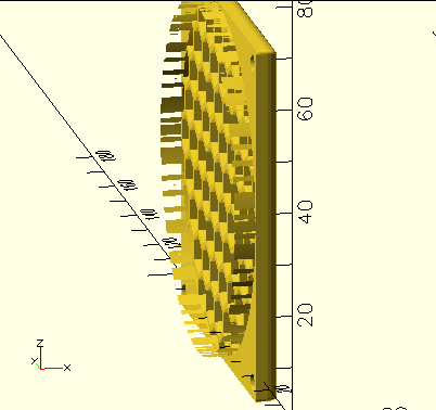

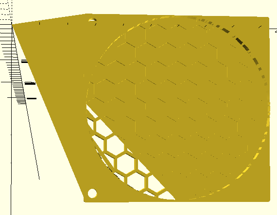

I am trying to manipulate an STL.
If I comment out the calling of the below functions, one at a time, the
result F6 render is fine.
  inner_grill();
  outer_grill();
If I F6 render when calling both functions, by ensuring they are both
uncommented, I get some unwanted material included.
Does anybody know why this is happening and how to prevent it.
I include the opscscad file and STL file I am importing.
Thanks,
Richard.

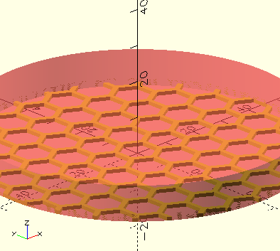

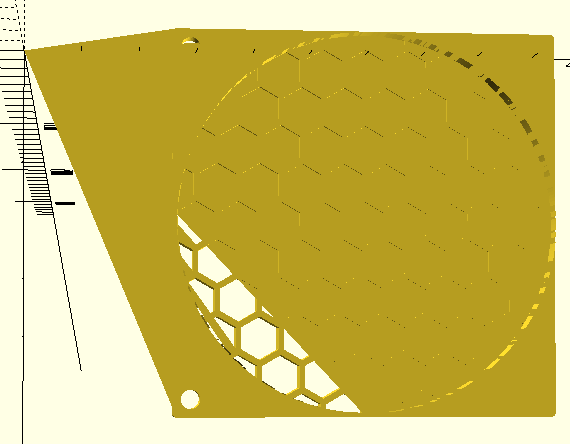

Are you talking about the tons of thin pieces extending into -X around
the outside of the circle?
If that's the problem, the minimum demonstration is something like:
intersection(){
    import("fanguard_90mm.stl", convexity=3);
    cylinder(h=10, d=89, $fn=360);
Alternately putting # in front of the two components yields
and

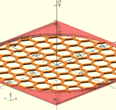

You're trying to match up the cylinder that you're using as a cutter
with the hole in the STL.  It both extends above the grillwork and
doesn't quite match up, so you're bringing in little slivers of the
frame - which you are then scaling up by a factor of two in Z, making
them taller than the frame that you're unioning them with.
The simplest thing might be to reduce your cylinder down to the
thickness of the gridwork, so that at least any frame that you pick up
just gets unioned back into the frame.
Also:  convexity=3 is not nearly enough for this design; if you look at
it edge-on the sight lines can be running in and out of the model many
more times than that.  Experimentally, 7 looks like enough, but I would
use 10.  This only affects preview.

I'm actually talking about the screenshot in my original email.  There is
material that seems to stretch to a common vanishing point.
I will change by value of 89 to be more accurate to the outer of the grid
work, as that does need remedying anyway.
Thanks,
Richard.

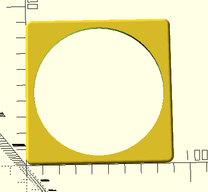

try -
module cutter(){
  cylinder(h=10, d=88.9, $fn=facets);
also from the wiki A $fn over 128 is not recommended or only for
specific circumstances, and below 50 would be advisable for performance.

Hi Raymond,
Thanks for that, it sorted the problem.
Just so you can see in more detail, when the cutter is set to a diameter of
89, here's a video showing better the problem.
https://youtube.com/shorts/SEWGn7CGrmI?feature=share
Cheers,
Richard.

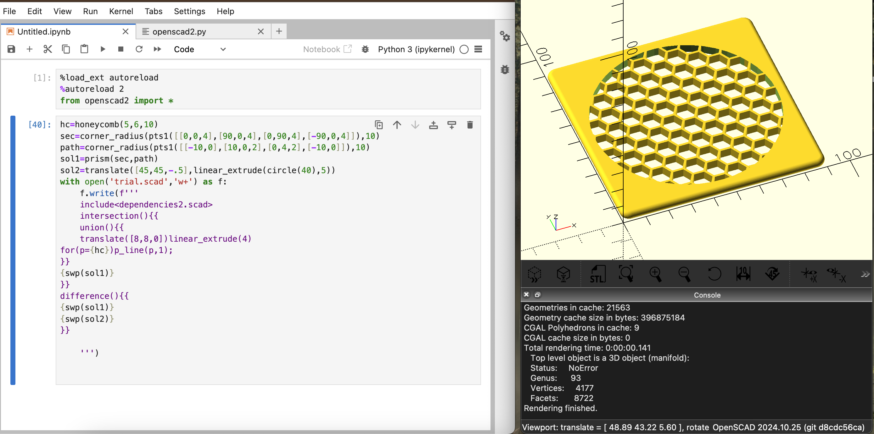

You can make this in openscad and this issue can be completely avoided.
As per my understanding there are libraries which can do this in native
openscad.
I can do it in python for sure and will share my code with you.

Here is the code I have written for something similar[image: Screenshot
2025-02-03 at 8.09.20 PM.png]

Here is the scad file
you need to include dependencies2.scad file for this to work.
Oh wow, that was quick, thank you. For some reason, the trial,scad only gave me the outer. [image: image.png] Any ideas? Thanks, Richard. On Mon, 3 Feb 2025 at 14:45, Sanjeev Prabhakar <sprabhakar2006@gmail.com> wrote: > Here is the scad file > you need to include dependencies2.scad file for this to work. >
