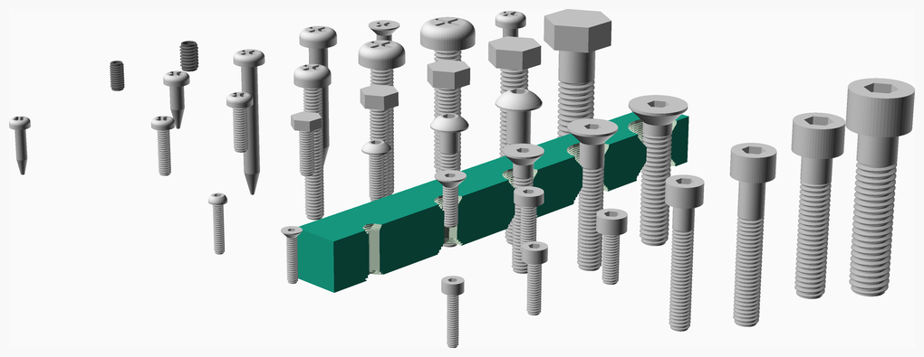

Not really a small library but you can use a small part of it:
https://github.com/nophead/NopSCADlib#screws

hm... something less experienced??? Am 08.06.21 um 10:39 schrieb nop head: > Not really a small library but you can use a small part of it: > https://github.com/nophead/NopSCADlib#screws > <https://github.com/nophead/NopSCADlib#screws> > > image.png > > On Tue, 8 Jun 2021 at 09:26, Karl Exler <karl.exler@meinklang.cc> wrote: > > Dear friends > > > I found many libraries for modelling srews and bolts. As my > requirements > are really very low and as I am not a screw specialist who is > willing to > re-invent the circle Iḿ looking for a small library only for > modelling > M2-M6 threads/bolts... > > any recommendations? > > BR > Karl > _______________________________________________ > OpenSCAD mailing list > To unsubscribe send an email to discuss-leave@lists.openscad.org > <mailto:discuss-leave@lists.openscad.org> > > > _______________________________________________ > OpenSCAD mailing list > To unsubscribe send an email to discuss-leave@lists.openscad.org

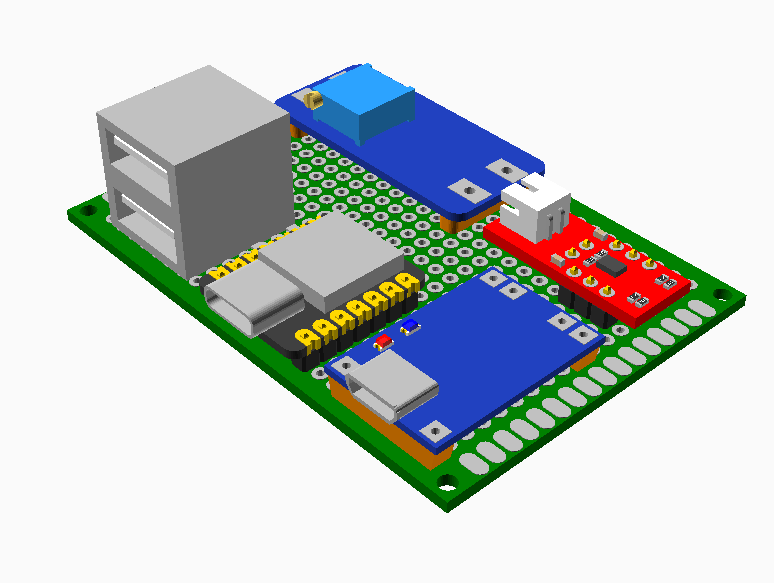

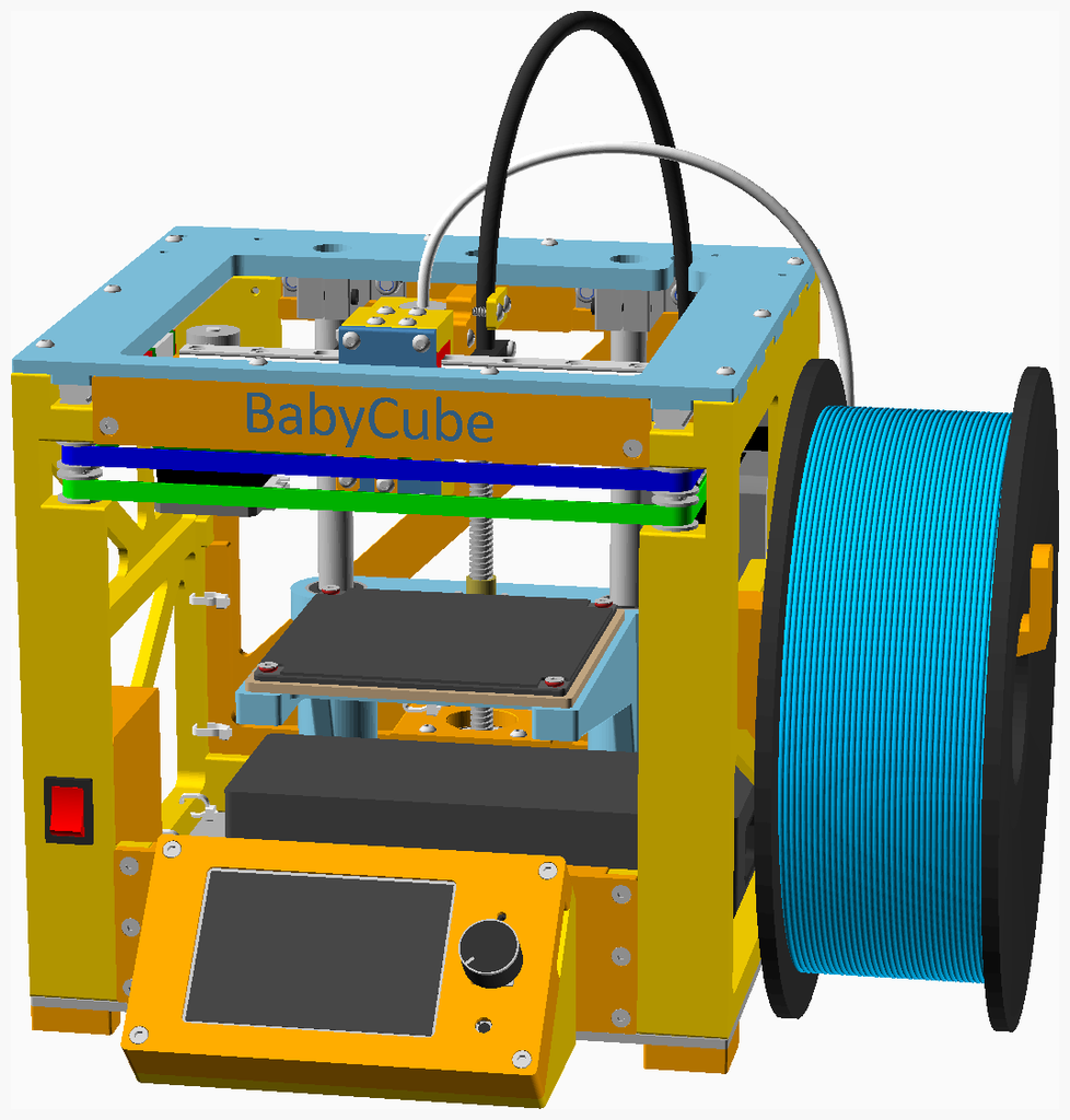

Yes, most libraries are more concentrated on making printed parts using
complex maths. My library is mainly for making accurate assembly views to
make sure my printed parts fit around them. Nearly every project I build
adds more parts to it. I am currently working on this perf board assembly:
and another user of the library made this cute printer with it.
https://github.com/martinbudden/BabyCube/tree/main/BC200

can not imagine this is all Openscad. Awesome! Things went very far way.
p.s: i see you like Wemos-like-ESP-boards too :)
I see your approach now, i also had to somehow model the
environment/assemblies several times, though rarely so precise, as you do.
very impressive.
Can't imagine how much work the printer was.
Is it near-real-time animatable? never!

I imagine the preview can be panned and rotated in near real time with the
vertex buffer options turned on but for an actual animation with the axes
moving I would expect it needs to be recorded as a video and played back
faster.
