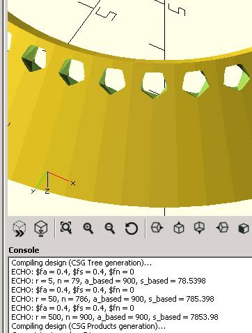

ECHO: $fa = 0.4, $fs = 0.4, $fn = 0
ECHO: r = 5, n = 79, a_based = 900, s_based = 78.5398
ECHO: r = 50, n = 786, a_based = 900, s_based = 785.398
ECHO: r = 500, n = 900, a_based = 900, s_based = 7853.98
Depending on size, it could explain the 9h render with 200MB cache.

Your $fs is too big for your intake small holes,
and $fa can make up to 900 segments:

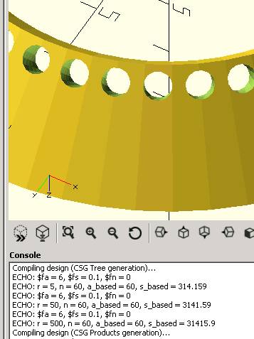

This may be better, but it depends on the sizes involved.

Regarding the code, it is a long one, but I commented all the other parameters and models and draws that was not intake.  So, the missing parts were just some parameters and the $fans values.  The changes are made after I saw the suggestions, was to cut out render() from the code, and raise the cache sizes to 2000MB.  I also unchecked “Automatic Reload and Preview”.
In my machine OpenSCAd runs on just 3 threads.
I see, that I have to play more with the $fans. ;-)
