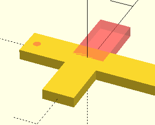

Next, just to see what's what, I started putting # in front of each call
to limb() to show where that call is (without having to do the rotates
and translates in my head).
That pretty rapidly led to the answer.  Putting a # in front of the
first call to limb(), the one in the difference(), showed:
Oops!  You're subtracting the circle from the wrong limb()!  You want to
be subtracting it from the 90° limb().

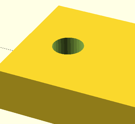

Also, even highlighted, a circular hole won't quite look like that.  It

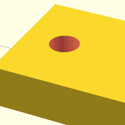

would look like so:
and if not highlighted would look like so:
