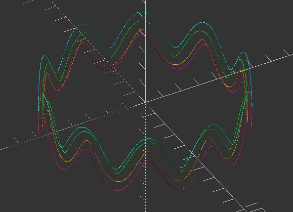

Hello,
Is there some library which could be used to automatically build a
volume from 4 groups of 3D points, each group representing an edge of
the polyhedron?
Here's a caption of the four groups of points (made with BOSL's
polyline). The global shape is a kind of donut with some sinusoidal
modulations.
Thank you.

I think the ClosePoints library is specifically meant to do
that. See https://openscad.org/libraries.html for links.
I have not directly used it myself though.

I don't understand what you are trying to do.  Perhaps BOSL2 skin()
can do what you need?  Or maybe just vnf_vertex_array()?  Possibly
also path_sweep() or sweep() may be useful for solving your problem.

Is this what you are looking for?
Attached file has a module named swp().
