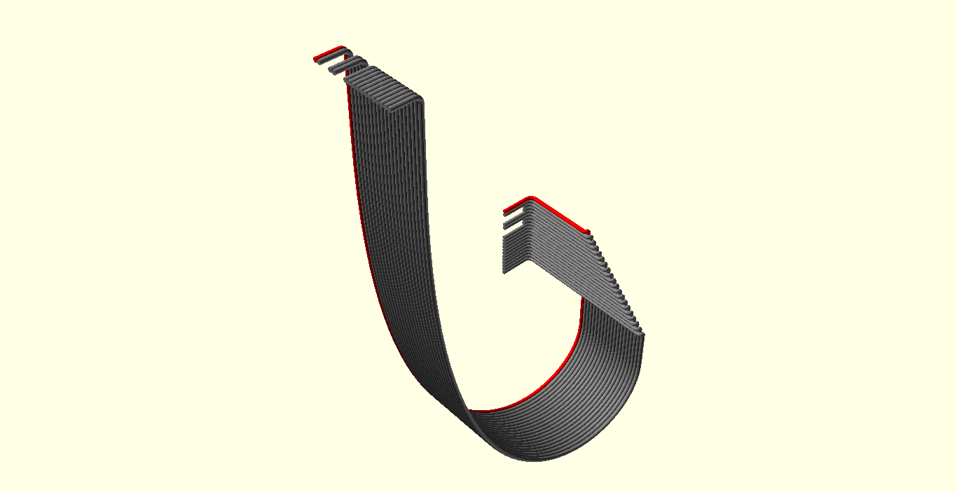

Once you start adding for loops and recursive functions the interpreter can
get slow. My code to draw a 20 way ribbon cable with a Bezier curve, a fold
and some bends takes about 20 seconds to compute and next to no time to
render. I am contemplating adding a time() function to to aid optimising it.

Well, the octree-based booleans seem to work.  Just a bit slow to generate
the octrees.
