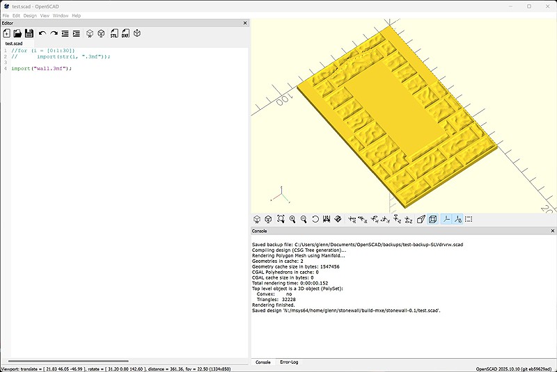

I'm building a scale model of a railroad station with stone walls.
Using heightmaps for stone textures, found out two things: 1) massaging
the heightmap  to represent a stone is not trivial, and 2) heightmaps
generate meshes that start to bog down render processing.  Cutting to
the chase, I wrote a program to generate stone walls, unimaginatively
called stonewall.  It's a command-line program that takes in
black-and-white pictures representing wall profiles, black background
and white stones, like this:
and generate a .3mf or .stl file that looks like this:

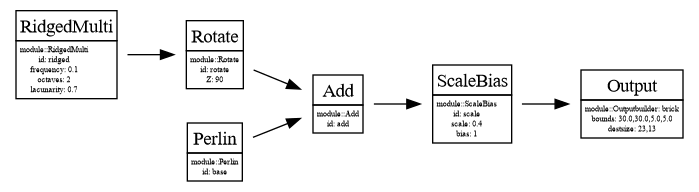

It's a kludgy program that uses OpenCV, libnoise, and Manifold libraries
to do the heavy lifting, where OpenCV FindContours extracts polygons
from the input image, libnoise generates a stone texture for each
polygon, and Manifold and some code I wrote use the contour to shape the
heightmap and generate the mesh. A particular feature is that it will
bevel the heightmap to the edges of the contour, representing how stones
are sometimes shaped for incorporation into a wall.

stonewall's simplify parameter is of particular interest. So-called
'naive' heightmap mesh algorithms take the row-column height data and
build mesh triangles between their implied coordinates; two triangles in
each such sector is minimum, but four provide more definition.  Either
way, that adds a LOT of triangles to the render. Being a
bear-of-little-brain, that's what I implemented in stonewall.  Just a
few days ago, looking at the Manifold documentation I found the
Simplify() method for the Manifold class, hmm, wondered what that would
do to mess up my textures.  To my delight, I found that small input
precisions significantly reduced the number of triangles in a heightmap
mesh without degrading the definition, at least for my target
application of 3D resin printing.  Correspondingly, it reduced render
times from tens of seconds to a couple of seconds max for the largest
wall of my model.  OpenSCAD might consider adding this as a parameter to
surface(), enabled when Manifold is the back-end renderer.
Anyway, for what it's worth...

That's what libnoise does, using math of a category called 'coherent noise' . Google 'perlin noise'...
stonewall reads network definitions digestible by libnoise; each time you run Stonewall with a particular noise definition,  you get a different pattern,  with the same general shape.

     program that
takes in black-and-white pictures representing wall
     profiles, black
background and white stones, like this:

libnoise is worth a study.  The API presents noise sources and various
operators as nodes, so the user declares nodes then connects their
sources and sinks to make a network.  I wrote a command line tool that
shells the C++ calls with a definition file, and stonewall uses that
parser internally to accept definition files and construct the
corresponding libnoise network.  The network I used in my example looks
like this (graph generated from noisetool dot-compatible output):
