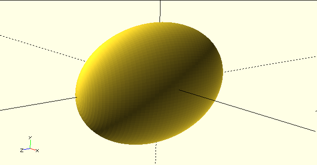

Sat, Feb 15, 2025 1:59 AM
original shape posted was this:
[image: Screenshot 2025-01-27 at 9.35.07 PM.png]
