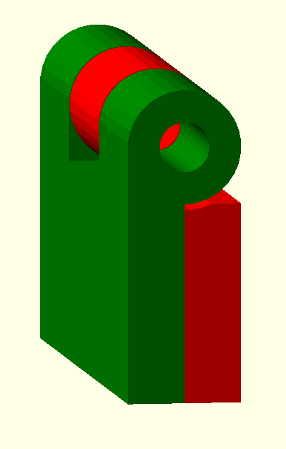

I want the two hinges in this example to have the flat parts lie flat
together, but cannot figure out how to modify the parameters to make
this happen.
// DNG Belly Support
include <BOSL2/hinges.scad>
inches = 25.4;
$fn=32;
eps = 0.01;
mw = 125;    // max width
// left/middle/right
cX = 2;
cY = 40;
cZ = 15;
pd = 1.9;    // pin diameter
module Hinge1h(th)
    cuboid([th, cY, cZ])
        position(TOP) orient(anchor=RIGHT)
            knuckle_hinge(length=35, segs=9, offset=2, arm_height=1,
pin_diam=pd, clear_top=false);
*Hinge1();
module Hinge2h(th)
    translate([0, 0, cZ])
        rotate([180, 0, 0])
                position(TOP+RIGHT) orient(anchor=RIGHT)
arm_height=1, inner=true, pin_diam=pd, clear_top=false);
*Hinge2(th + bt + th);
th = 2;            // thickness
bt = 7.2;        // board thickness
sthd = 1;        // stitch hole diameter
schd = 4;        // screw hole diameter
lm = 0;        // left mode
mm = 1;
rm = 2;
module Hinged(b, m) {
    if (b) {
        Hinge1h(cX);
    else {
        Hinge2h(cX);
color("red") Hinged(true);
color("green")
    translate([5, 0, 15])
        rotate([180, 0, 180])
            Hinged(false);

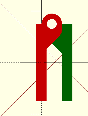

Hi Jon,
As an exercise ,I've just done it in pythonscad. Not too difficult. It
should be the same in openscad wrt simplicity.
  1. make a cross-section of the hinge profile, basically a square with a
    circle at one end. Make the circle, centred on the origin, say, the diam
    of the hole for the pin plus twice the thickness of the leaf (name it d,
    say)
2)linear extrude it the length of a hinge leaf, and  make leaf1 and
leaf2 equal to that original leaf
3)make, n= the maximum number of segments on one leaf, 5 in your case,
so divide the length by n+n-1, to get to the spacing requirements
Then you need to think about the fitting tolerance, say tol=0.2 (but
test your code by making tol much bigger)
  1. using for loops, say, difference a cylinder of diameter d+tol, and
    height of tol+(leaf/(n+n-1) through leaf1, and offset by height (more or
    less) for leaf2
  2. this is not a print in place version
  3. if needed add ornamentation, fixing holes, etc.
by drawing a cross section, and linear extrude, you can obviously simply
design cranked or other hinges.
I could post the python scad code if any use, but basically it follows
what I  outlined above.
Best wishes,
Ray

I don't immediately see how either.
One key component is that each side needs space for the other side's
"knuckle" to be subtracted from it.  It looks like the clear_knuckle
parameter is somehow tied to that, but it's only weakly documented and
doesn't appear to really be implemented.
Note also that to make this happen the hinge pin hole needs to drill
through the part, not just through the hinge.  (Or the hinge needs to be
moved so that the hinge pin hole is entirely above the part.)

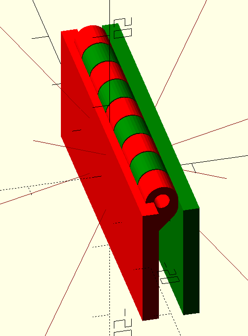

Tue, May 13, 2025 11:49 AM
Here's an attached  hinge, simply based on what I mentioned before. If
the reinforcement fillet is required, then it should be simple enough to
alter the profile. Depending on which side of the leaf you want the
fillet, then  instead of differencing a cylinder+ tolerance, you'll need
to difference the cylinder+fillet+tolerance. I've not tested by printing
the .obj file, it should be good enough, but I could well have missed
something.

Attached pythonscad script, fwiw

want, you need to design a hinge that has its centerpoint aligned with the
edge of the object it's attached to.  Note that such a hinge won't actually
work in reality.  You need clearance between the plates. I looked at a
couple real hinges and the expensive one is about 20mm long hinge with a
bit less than 1mm of space between the leaves when they are parallel.  The
cheap one had much more space.  But here's a way to do what you requested.
I also activated knuckle clearance, which appears to be working fine.  How
did it not work for you, Jordan?
include<BOSL2/std.scad>
include<BOSL2/hinges.scad>
$fn=32;
kd=4;
color("green")
diff()
cuboid([20,kd/2,7],anchor=BACK)
position(TOP+BACK)
knuckle_hinge(20, segs=3, offset=kd/2, knuckle_clearance=0.2,
knuckle_diam=kd, arm_angle=90, arm_height=0,
clear_top=true);
color("red")
diff()
cuboid([20,kd/2,7],anchor=FWD)
position(TOP+FWD)
yflip()knuckle_hinge(20, segs=3, offset=kd/2, knuckle_clearance=.2,
inner=true,
clear_top=true);
