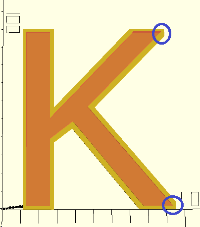

I'm trying to get a border round this letter 'K' that looks very like a
larger K.
What I am getting is a 'squaring off' of the 'K' (I am using a cube in my
minkowski after all!
Is there a way that I could achieve what I have done below, but with the
right extremities coming to a point and not having that flat bit that runs
vertically?  Thanks!

Not sure what you're aiming for, but I think you might be able to do
what you want by using the 'offset' command on the 2D shape before
linear-extruding it...

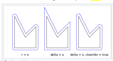

Ah, that function is ideal as I am after the middle image in the below (and
I'm kind of getting the right image).
I'll go and try it now.  Thank you.
