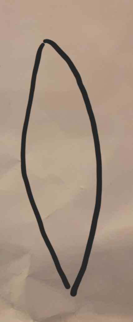

Thanks to OpenScad I remember and restore many of my  high school math skills.
Unfortunately I was very weak in functions in the last two years.
How would you go for creating patterns like the attached one.
(The next step is rotating it and create Mandalas or something fancy for fashion jewellery. )
Thanks
Karl
p.s. If I need a quick and dirty solution I draw it in Inkjet.... but I would prefer a "math"solution

Depends on what curvature you are thinking of. On my mobile, so not tested:
translate([8,0]) circle(r=10) ;
translate([-8,0]) circle(r=10) ;
If you just want the outline replace the circle with a module that creates
a ring.

Check the various Bézier curve modules?
https://forum.openscad.org/smoothing-2D-curves-in-BOSL2-td32085.html
