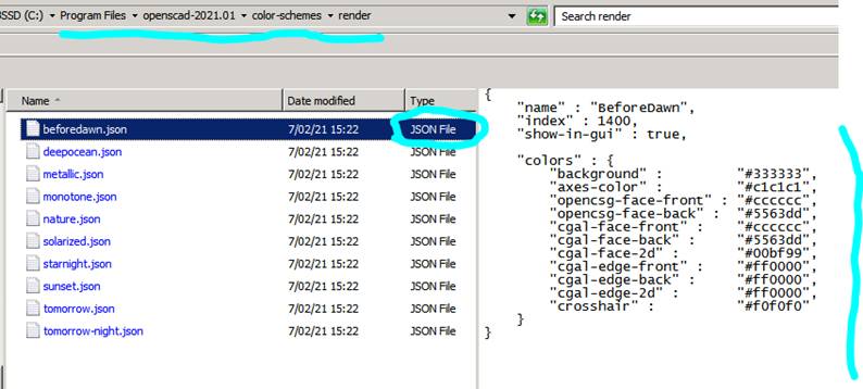

Sat, Mar 19, 2022 11:07 PM
In case you don't know, the others schemes are in JSON files under "program files" & equivalent &
you can create your own:

Sun, Mar 20, 2022 12:52 AM
On 20.03.22 00:19, Adrian Mariano wrote:
so it's presumably reasonably safe to assume that the
default color scheme is in force.
Nope. I'm always using the Tomorrow styles for both rendering and
editor. From the screenshots attached to github issues and posts on
twitter, it's safe to assume there's at least a good percentage of
people switching to other color schemes than the default Cornfield.

Sun, Mar 20, 2022 1:11 AM
On 20.03.22 02:09, Adrian Mariano wrote:
How do you even learn this is possible other than by asking here?
Read the source?
Edit -> Preferences -> 3D View
On 20.03.22 02:09, Adrian Mariano wrote: > How do you even learn this is possible other than by asking here? > Read the source? Edit -> Preferences -> 3D View ciao, Torsten.

Sun, Mar 20, 2022 1:27 AM
https://en.wikibooks.org/wiki/OpenSCAD_User_Manual/The_OpenSCAD_User_Interface
There are predefined color schemes that can be selected in the Preferences dialog.
https://en.wikibooks.org/wiki/OpenSCAD_User_Manual/Using_OpenSCAD_in_a_command_line_environment
--colorscheme arg            =colorscheme: *Cornfield | Metallic | Sunset |
                          Starnight | BeforeDawn | Nature | DeepOcean |
                          Solarized | Tomorrow | Tomorrow Night | Monotone
https://en.wikibooks.org/wiki/OpenSCAD_User_Manual/Print_version#Chapter_7_--_Path_locations
  • render color schemes: [ResourcesPath]/color-schemes/render
  • editor color schemes: [ResourcesPath]/color-schemes/editor
