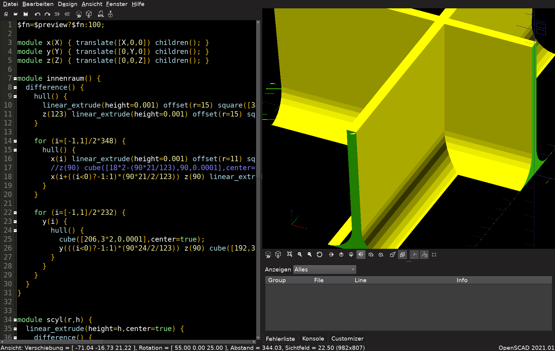

IMO the problem is that QT (and basicly all other frameworks) do not play well with automatic colorscheme creation - e.g. light gray text on dark gray background might look cool, but if you happen to be visually impared this is a nogo. As long as I still can use my own colorscheme (see attachment) things are ok, but if you rely on QT to make thing right ... not so good.
